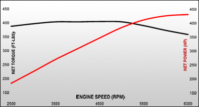

I'm done then. You want to argue with no basis of fact and apparently I cannot put it into terms you understand. I will leave you with this graph of HP and torque though. Notice how they cross at around the 5252 RPM range.
As I stated, If torque increases with rpm, i.e. both factors on the right hand side increase, then their product (HP) will also increase.
Pay attention. In your graph, power, not torque, increases with RPM. If power increases with RPM torque does not necessarily do so. However, if torque increases with RPM then power necessarily increases too.
As to this compleltely un-interesting crossover value, it is 5252 rpm for torque expressed lbxft. It will be at a different rpm for Nxm. So what?
Dude. I was just trying to show you why your torque runs out before you reach red line and why going there (past 5252 rpms) does not give you anything. Basically validating what others had already said.
Again, 5252 rpm is the value you happen get when you use pounds x feet for torque units. It's when torque and power happen to be numerically equal. It's completely accidental and unimportant. In Europe it will be some other number.

The calculation is elementary but that's not the point. engineeer attaches importance to the fact that at 5252 rpm the torque (lb x foot) is numerically equal to power (in horses). From that observation he concludes that exceeding 5252 rpm is bad for torque. In Europe they use other units for torque, so the magical RPM over there is different.
