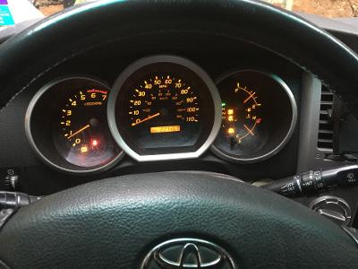

What has triggered this dash light display?
rwh963
Member
these lights have been on for quite a while. not an uncommon group, research shows, but i still don't know what has been the cause. vehicle runs and drives fine, so i can't be anything serious. TPMS, VSC OFF, VSC TRAC, and slippery car icon. tire inflation seems ok (even pumped up the spare). gas cap??
abs speed sensor wire.
Most store bought obds dont show toyota abs codes. To check the obd codes you'll need Toyota tech stream or obd d'ongle with the motor data app and the 4runner addon. or you can use a paper clip connect E1 to Tc which is a little more involved.
You will be surprised, but weird lights combination SOMETIMES is malfunctioning of transmission selector switch. Goes bad of wires corrosion or parking on inclined surface, or off roading in deep water or something else.
switch itself like $150. Try not damage transmission rod while replacing switch. To check just disconnect it and see what happened.
The TPMS light could be due to a bad sensor. After a few years (like 7 or 8) the battery in the sensor dies and the computer sees this as a problem and turns on the light. I have a TPMS light on my 2013 SR5 even though all the pressures are good. On my SR5 I don't know which one (or more) is the culprit; so one of these days I'll have them all changed out. Not cheap as previous threads have mentioned.

Having owned a 4th gen, possibly two different things going on:
1) Spare tire is low on air and triggering TPMS (yes, the spare is monitored)
2) The mommy switch is turned off or is malfunctioning

i did stop at auto zone for a scan, but they said they only do CEL scanning.
my guess is tpms. they are original to my 2007. i believe have had these lights before, pumped up all 5 tires (spare was around 17 lbs). eventually went off. i'll keep an eye on the pressures. dealers often run free code readings, though i hate going there knowing they will come out with a $5k estimate!

Abs, emergency brake, vac, 4-lo wheel, all lights that come on
Fix was replacing wiring harness on the drivers rear quarter panel…ordered it from Toyota ($230.00)
No more warning lights
speaking to toyota service and parts, it is most likely one or more of the TPMS sensor batteries that has failed and has triggered the stability control lights. computer thinks i have low pressure in one or more tires. don't know is there is a way to disable this signal until replacement.
