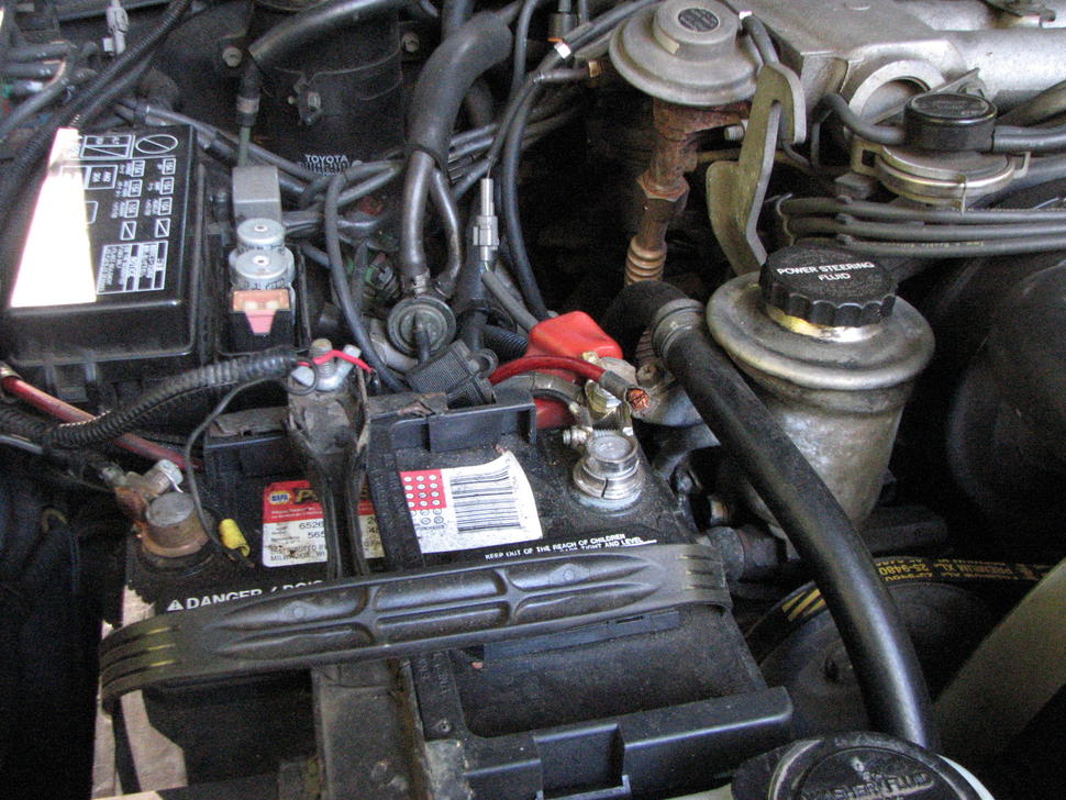

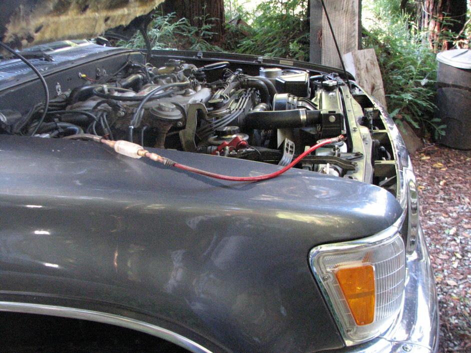

Found the cable loose, not sure where it but found an eye type connector on the positive battery cable it appears the other end was attached to? Removed cables last night to charge battery, may have broke loose then. Comments, or suggestions on either question would be appreciated!
*If the cable does attached to the battery can I crimp another eye connector?
*What appears is a filter of some type, purpose unknown, could it have been damaged as a result?
Thank you, Dave

Its a power wire and fuse for a amplifier for the audio do you have a. Amp and subwoofer out back.? If not no need to hook it back up
Believe I have the standard but high end speaker set up that originally came with the vehicle and it's working fine. Some 20 plus years ago had an alarm system installed, there's already 1 power wire as a source, although I removed the fuse? It does appear the cable came out of the eye type connector, intend taking it to local auto parts for replacement, reconnect, whether it serves a purpose or not, but continue to test the various circuits.

You could try following the cable to see which way it goes if it goes out of the engine bay.
I vote you turn the truck on and see if anything that used to turn on doesn't anymore. :jk:
The cable in question joins 2-3 other circuits wrapped in plastic flex type conduit, too lazy at this time to cut and search. As best as I can determine, all is workin? No sure about the inline contraption, does not appear to be a fuse to me? If I were to hazard a guess, kinda leaning towards the vehicle alarm system?? I will continue to explore until I something does not work?

check your positive battery lug to see if you have an extra loop connector (the other half that broke off the end of the cable)
Yes, found an extra loop connector w/out a cable. Have since replaced the loop connector and reattached the cable. Also, took a close look at the inline doohickie and it does appear to be a fuse, strangest I have ever come across.
Thank you for the input!!
It looks like about 4 or 2 awg wire which is usually for an amp or even an air compressor at times. You'll probably have a ground wire somewhere in the truck also if they left that behind too. My rule of thumb is to never trust a previous owners installation if it involves a custom installed power wire. Keep it safe so you don't run the risk of catching your rig on fire
Dont supply power to it until you know where the other end is. For all you know it could be loose and not connected to anything. If you power it up and it touches a ground source it'll pop your fuse. Make sure its terminated properly if you power it up.
Recall working in that area of the engine compartment in the past and recall the cable was connected to a source, but I did not pay attn. where. Searched the general area for the possible source and appears the 'empty eye loop' connector is a reasonable possibly? As mentioned, I charged the battery the previous night and possibly the cable came loose at that time? Probly should remove until determine what the other end attaches to, better safe than sorry?
