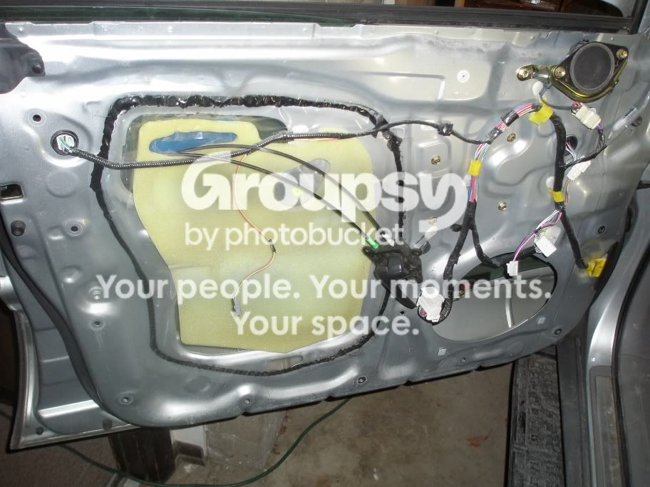

Here you go Mark
P3050080.jpg~original

Thanks for the pic. That gives me a better idea of what I'll be getting into tomorrow when I install my components.
It's best to keep the moisture barrier. And any components you add to the door should be on the INSIDE of the moisture barrier.
