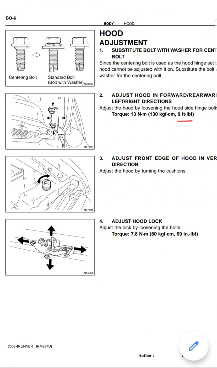

What is the torque for the hood bolts?
jross20
I keep finding 9 ft lbs and then 69 ft lbs which is an insane jump.
I don't wanna break my hood haha.
Specially, I need to know the torque for the bolts that thread into the hood.
9 ft/lbs sounds right. The 69 was probably meant to be in inch/lbs for the hood lock.
I honestly don't see them being 69 ft lbs. 9 ft lbs sounds better. I just tighten and loosen them with standard 3/8 ratchet as they are not super tight at all. :)
