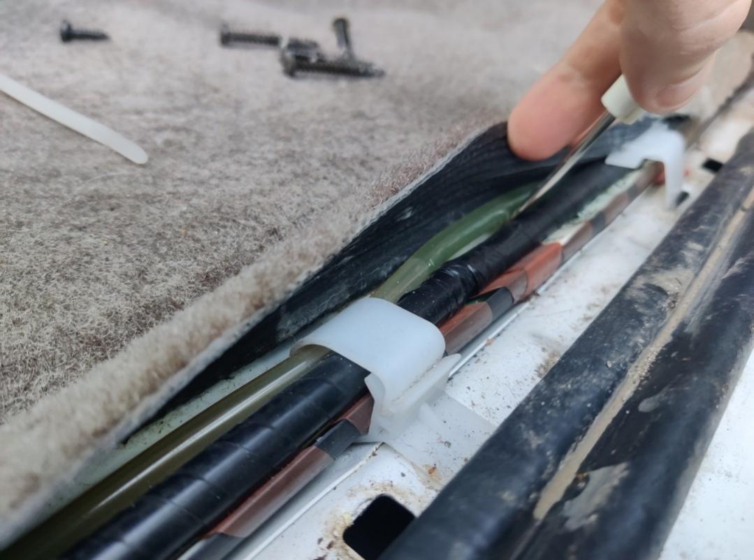

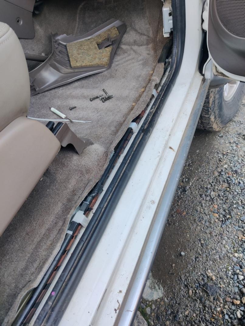

Hello all,
Did some looking but couldn't find what this line is for. It seems clogged, and potentially could be contributing to an interior leak.
Thanks in advance

Isn't that for washer fluid? I thought the sunroof drains run straight down the A-pillars then through the floor, not across.
That is your rear window windshield fluid line. The sunroof lines run down the a and c pillers. Front sunroof into the rockers. Rear sunroof you see coming out quarters. :)
It's your rear peir. Along the passenger wiring.

Oh yeah I guess it wouldn't be a very effective drain if it was going horizontal along the bottom huh :doh:
Don't be too hard on yourself...:-) I completely tore apart 2 3rd gens....So that helps with recognizing what components are. :-)
I can confirm it is the rear window washer fluid line. My rear window washer line broke and I found the leak by commanding fluid until water started leaking out, which it did right where your looking.
