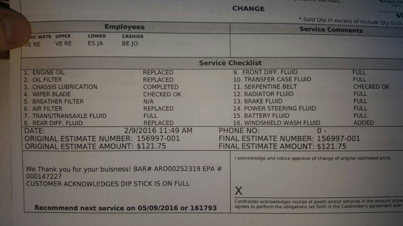

I paid to have my drive shafts/u joints lubed 10k miles and 10 months ago, but im beginning to suspect it wasnt actually done. At least not fully.
There are a quite a few zerks on the rear driveshaft, so I wouldn't be surprised if the technician didn't manage to lube them all.
Thanks for the replies guys. I will definitely look into this. I will probably end up having another technician do it because I will be out of town for the next couple weeks and then needing this truck for a 1000 mile road trip north just a few days after I return, but ill have them look at that diagram to make sure they get them all this time.

Just like to revive this and report that getting my drive shaft lubed appears to have fixed the problem. No noise for two weeks now. I made sure they got to every zerk and provided diagrams just in case. No doubt the mechanic thought I was being silly
