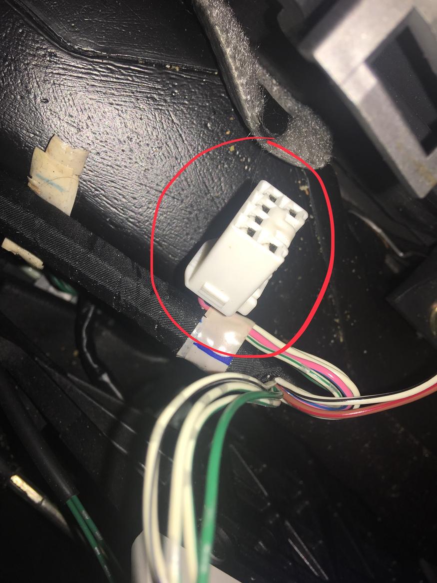

Does anyone know what the plug is for? It is in the center console and not plugged into anything.
I found the info below in another thread when I was under my console a few weeks ago.
That is the connection for the ashtray with cigarette lighter. The wires are as follows:
Cigarette lighter:
Hot - Pink with Blue stripe
Gnd - White with Black stripe
Cigarette Lighter Illumination
Hot - Green
Gnd - White with Green stripe
Ashtray Illumination
Hot - Green
