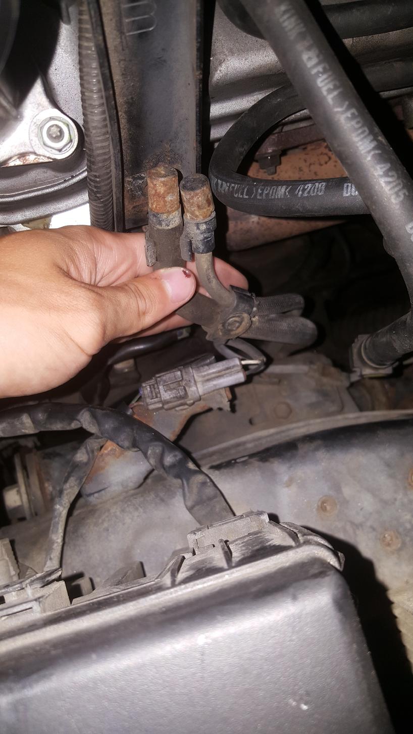

Can someone help identify this? I have my front left speed sensor bad and I need help identifying where to check its wiring before buying the sensor if I can save some money. This photo was taken on the driver side by the battery. My t4r was a northern vehicle for 6 years and also it is a v6 4x4 if this helps.

Yes that's those a breathers for trans and diff.
For speed sensor wiring you may also hear is called "ABS sensor" wiring. It will be running along your upper control arm (attached with a clip that's bolted on with a bolt with a 10mm head) and then run down the knuckle and be bolted into the back side of the hub. Follow this wire here...
