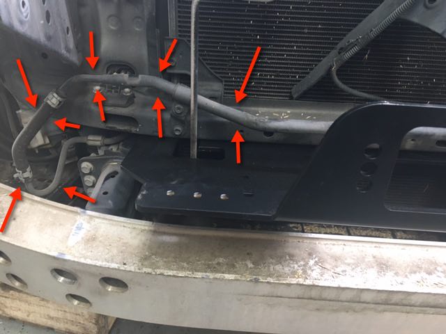

Does anyone know what this line is for? I suspect KDSS, but I'm not entirely sure? It's in a bad spot for the hidden winch install. I made it work for now, but before I crack it open and move it up 6-8 inches I want to be sure.
I believe that's your AC line. I bent mine back just enough to not touch the control box
Sent from my Pixel XL using Tapatalk
I know the vertical line in the pic is definitely AC, the horizontal line that the arrows point at can't be to high a pressure since it only has basic hose clamps keeping it in place.
It's definitely not a/c. Does it go into the radiator? Have you traced it to see where it came from and where it ends up?
Probably power steering. I didn't move any lines and ran a BudBuilt hidden winch mount for at least a year or two with no issues.
For sure not KDSS, all of those lines run along the driver's side frame rail, between the KDSS pistons.
Yes, it is the power steering "cooler" line. Mine doesn't interfere with the winch but I've thought about swapping them with something like this:

How about a link to how to bleed down the power steering system after it's been cracked open and air is introduced to the system?
I'm sure somebody's got that laying around someplace. Point me to it please
Lots of youtube vids on this as well.
So basically:
1) Crack open the system
2) Move the lines, hoses etc. Do whatever mod to it that is needed to relocate it.
3) Close the system back up.
4) Fill the reservoir.
5) Fire it up turn the wheel all the way left and all the way right several times and the system will bleed the air out.
6) Make sure to keep the reservoir full during that process so more air isn't sucked back into the system
2 people would be handy to make sure the reservoir stays full.
Seems easy enough. should be no problem.
I would recommend having the wheels off the ground and turning them back and forth, slowly with the engine off until you stop getting air out. Then, start the engine and turn the wheels back and forth to get the rest of the air out.
