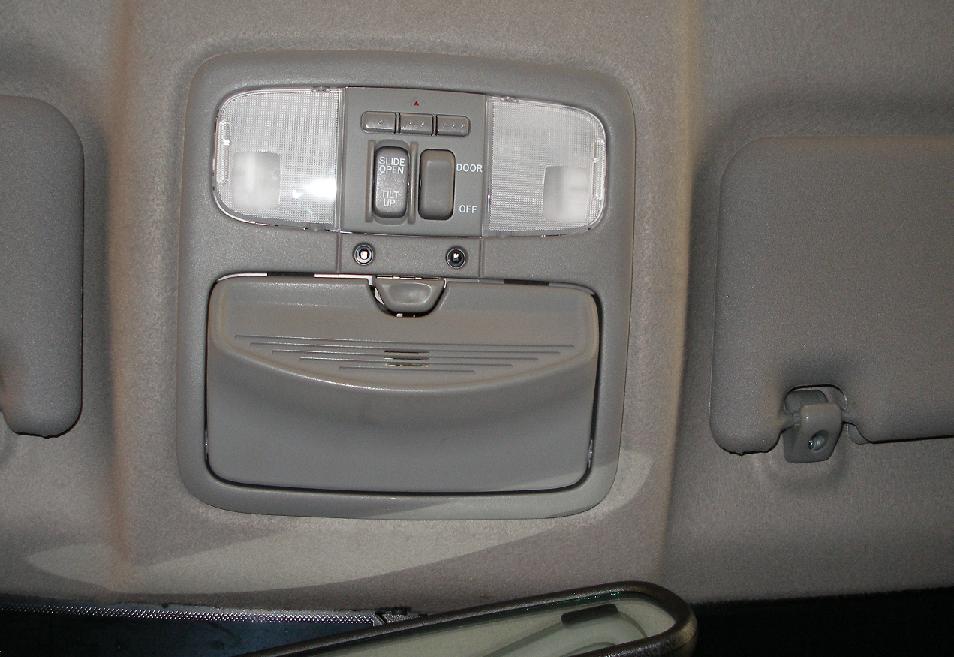

However, my favorite mod has actually been the addition of the Lexus overhead console, and the lights I installed in the footwell areas for the driver, and front passenger. The Lexus console allows the dome lamps to come on when the doors open and has ambient lighting built-in. My 4-Runner was so dark when I first got it. Now it's nice & bright at night and I can actually see without having to use one of my SureFire flashlights!
That is an excellent modification, A/V1!
Please, how much did it cost, and how difficult was the installation?
Thanks.
Thanks.
Thanks! I really like it. The additional lights with the doors open makes a huge difference. If I remember correctly, the console was around $100. I got a few other things as well at the same time, so I can't say for sure. Just don't remember.
The install wasn't too bad, but it all depends on your abilities. It has a completely different connector receptacle, so you'll have to modify it for your truck. I chose to remove the connector receptacle from my original, and solder it on in place of the Lexus receptacle. I wanted to leave the vehicle-side connector alone.
Of course, you can put ANY plug/receptacle combination on it as long as you are willing to replace the vehicle side (mating end).
