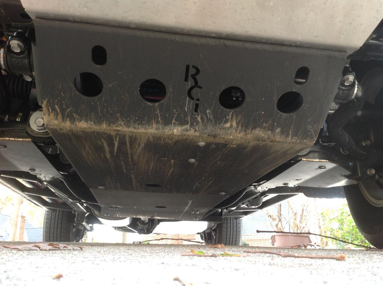

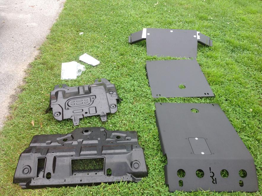

After I bashed my skid I had the exhaust hitting the skid. The easiest solution was to put an adjustable clap around the rubber exhaust hanger (driver side) and tighten. This brought the exhaust away from the skid so it didn't touch.
Pics for [MENTION=120033]Enzo4370[/MENTION]

I also have an RCI plate and it looks just like the one in the photo above--all scarfed up from smacking rocks. The RCI KDSS plate hangs down lower than the stock plate, which pretty much required me to add the Daystar spacer kit to get more ground clearance in the front. Now I have 10" of clearance and am not hitting as many rocks. Love the RCI plate!

The clamp on the bracket is not a bad idea for a quick fix, I would just worry a little about causing a crack in the manifold...

I moved mine maybe 1/2 inch off the skid. I doubt it will put that much stress on the manifold to crack it... I hope. :bathbaby:

So, a stupid question. Does the RCI front skid replace the 4Runner front skid AND the short little mid skid that has the oil drain plug door in it? I assume it does based on your top picture, because the RCI skid looks to be about as long as both of the OEM skids put together, and the drain hole in the RCI skid loosely lines up with where the oil drain door is on the OEM skid.
And yeah, I realize this is a two-year-old thread...
Someone correct me if I'm wrong....
But the RCI front skid will only replace the factory engine skid and not the secondary skid behind it. You will remove the plastic air dam in front of the factory engine skid. Get the RCI filler plate.. Worth it!
