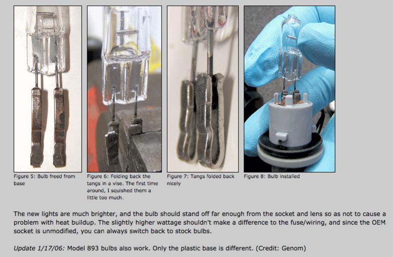

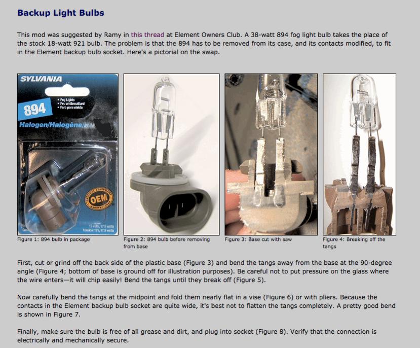

Here's a Mod you might want to try. Basically, it consists of buying a 37 watt bulb, cutting it out of the case, bending the pins, and using it as a replacement for the factory 921 T-wedge bulbs which are only 18 watts.
The thread is inspired by a post on a Honda Pilot forum. The post comes from
a web page on someone's skidmore.edu page that can be found here.
I'm copying images of the post and attaching them to this thread, just in case the skidmore page ever goes away.
I haven't tried the mod, but I *might*. It sounds promising.
-Phil

The mod I posted to an 894 bulb, uses a halogen bulb that is twice the wattage of the factory 921 bulbs.

I'm working on putting 894 bulbs in my reverse lights. I initially followed this post:
http://www.toyota-4runner.org/1321699-post324.html
But it turned out not to be the best way to do it. The bulb leads get hot enough to melt solder, so I don't recommend using solder terminals. I used part of some crimp terminals, and stuffed in extra copper wire to fill up the space around the bulb wire. If I did it again, I would keep the flat blade contacts on the bulb since those are closer to the shape the socket needs. Folding them in half should be perfect.
The bulb still got hot enough to slightly burn the plastic insulation on my crimp terminals, but not hot enough to cause any other problems running it for about 5 minutes. You might think you'll never back up for that long, but if you get stuck on a narrow trail with no way to turn around, you might need to.
I've done one so far, and I'll do the other one soon. 894 is the hottest I would want here. I think 886 would be too hot. I decided not to do LEDs because they are too expensive for only a small improvement in light output. With one 894 bulb in there so far, it's better but not life-changing. Auxiliary lights would be needed if you want to see really well.
