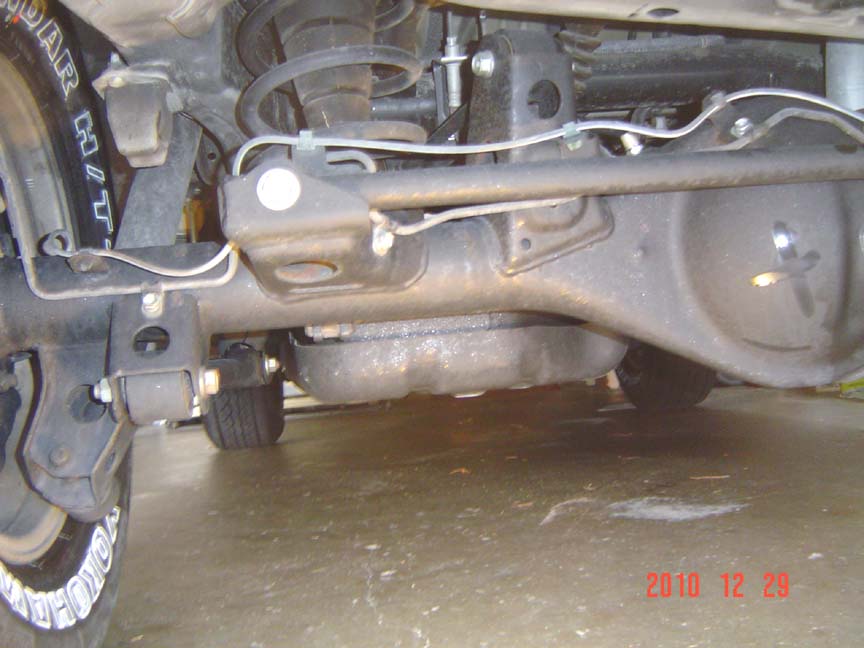

Today’s General T4R Inspections went well: (I was the inspector 70/80s with Sun’s Eqp).
1. All disc pads as tires are new, there has to be a way to see them w/o pulling wheels.
2. The frame and suspensions at all 4 wheels looked good.

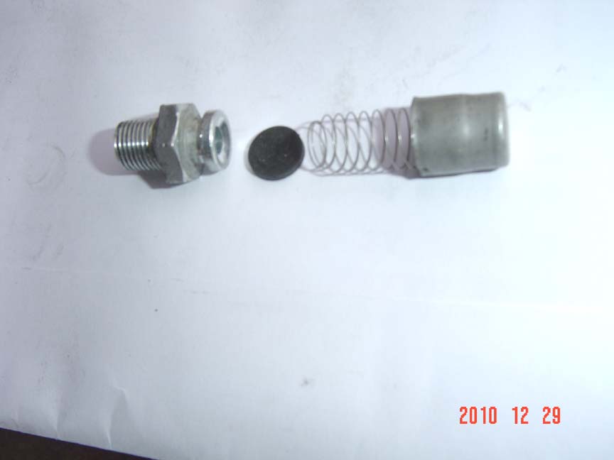

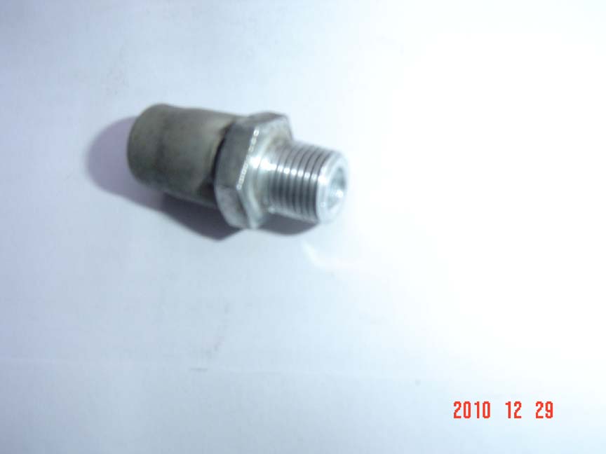

3. The rear-end’s oil looked good. What causes the pressure build-up I had to bleed-off?
4. The engine and trans pans had no signs of leaks.
5. Front and rear U-joings felt and looked good.
6. The engine compartment is spotless, the engine sounds good, w/o a compression test.
7. All inspections were documented w/pics for future use and Pic w/sound on the motor.
So far all is good. BUT! I’ll still ask why were they trying to charge me for un-documented inspections/services when it was clear the rear-end’s plug h/n been pulled and no under-coat and etc but there were new tires and brake pads. They played with numbers to void the charges that maybe we can play with as a refund for my efforts. I hope the alignment shows a problem that is easily corrected to end these matters. I need to retire these tools for the next 15 years as my 70’s floor jack, jack stands and torque wrench asked, “I thought we were retired”! jow
Is the T4R rear-end not venting a common issue? This is my 1st rear-end to see pressure in after owning 2 Jeep Wagoneers about 20 yrs. I’ll have to cleanup my inspection since I’m going back to dealer this week related to the pulling alignment and heavy plastic mats that were shown (but not delivered). I haul STUFF due to handyman work and volunteering requiring tools. The cargo heavy rubber mat is better than my hard ASB formed plastic shell that is not tailored not to mention my truck shell for hauling firewood. The T4R will love the care and Stuff we’ll do and both of us will be thankful that I'm slowing vs 4 cords of wood. LOL jow

The rear end vent inspection went well. I’ll suggest that you d/n disassemble it if it’s clean and presses down easily (to say it will seal etc out). It’s too hard to reassemble. I could blow out though it and c/n suck through it by mouth. I feel the excess amount of pressure I bled off initially was due to the size of the axle’s cavity volume vs high pressure. “Too much pressure can blow the rear axle seals and affect brakes”. That will end my initial inspections unless some one has some good suggestions. Without draining engine, trans, rear end oil and compression (as I did on older cars with my young body) I feel I inspected a few things the pros w/n. I call it Old School or protecting an investment. Attachments will show the vent on the left of the R/E, assembled and disassembled. A good tip I noticed and experienced, the fill-plug is soft, use a 6 point socket vs 12 and a break-over was ideal for me.
