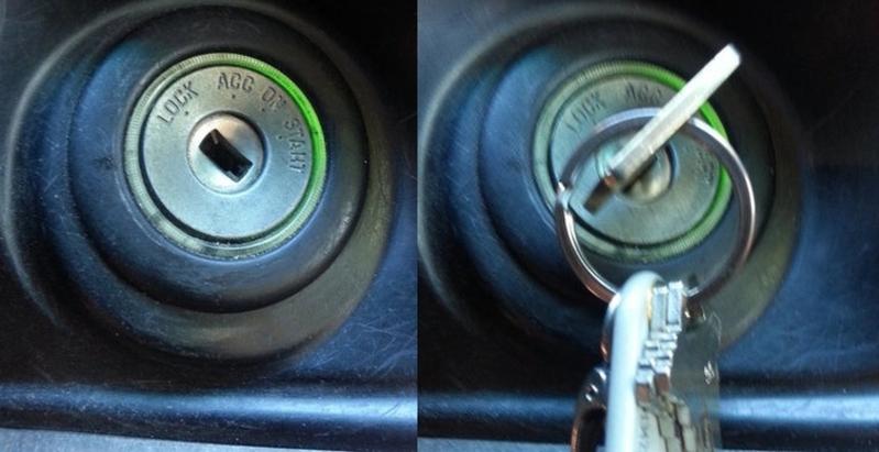

I press in the clutch, twist the key, the dash lights up properly, but nothing clicks.

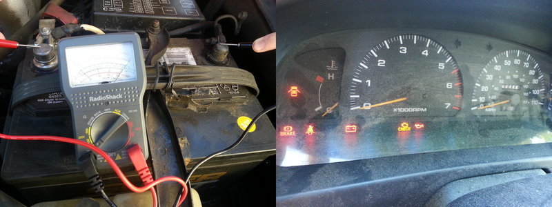

The battery test good at 13 volts with a meter but I jumped it from another car and put it on the charger anyway, but neither made any difference.

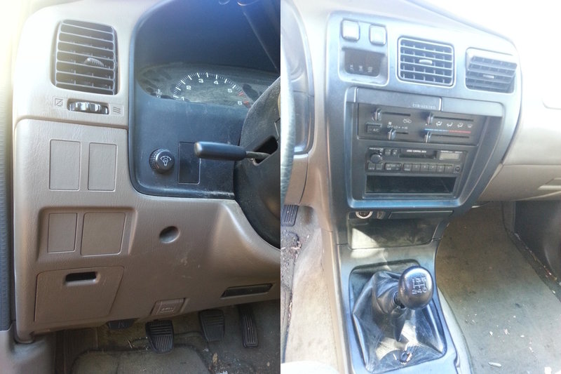

Well, there is a switch to bypass the clutch switch right on the dash. Hit the button, orange light comes on, and twist the key. If it starts then, the clutch switch is the problem.
If my 2wd 4runner has this switch, that will be a great diagnostic test.
But I can't find this switch on my dash.
Do you see where it is in these pictures of my dash?

OOPS, sorry. You don't have it. I thought all 5-speeds had it. Always something new to learn.
Cassette deck! Cooool!:heh:
Well, if you do the test at the starter relay, voltage at Terminal 1 with key in START position will eliminate the clutch switch as a possible cause.
You don't have it.
That explains why I couldn't find it. My dad always told me the eyes are the best diagnostic tool!

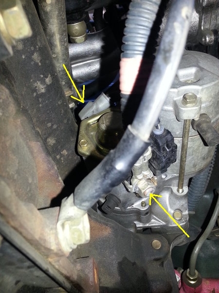

It's easy to get a test lead on the bottom side of the starter solenoid, but it was impossible to get a test lead on the top.
I couldn't even get my fingers on the rubber protection cap. I don't know how anyone can get in there without something special. I'm still trying, but, I figured I'd report back that I'm stuck trying to get a test lead on the upper solenoid connection (I have the ignition in the "on" position).
Did you try to go in through the wheel well? I don't know your engine but that's how you do a 3.4 V6.
