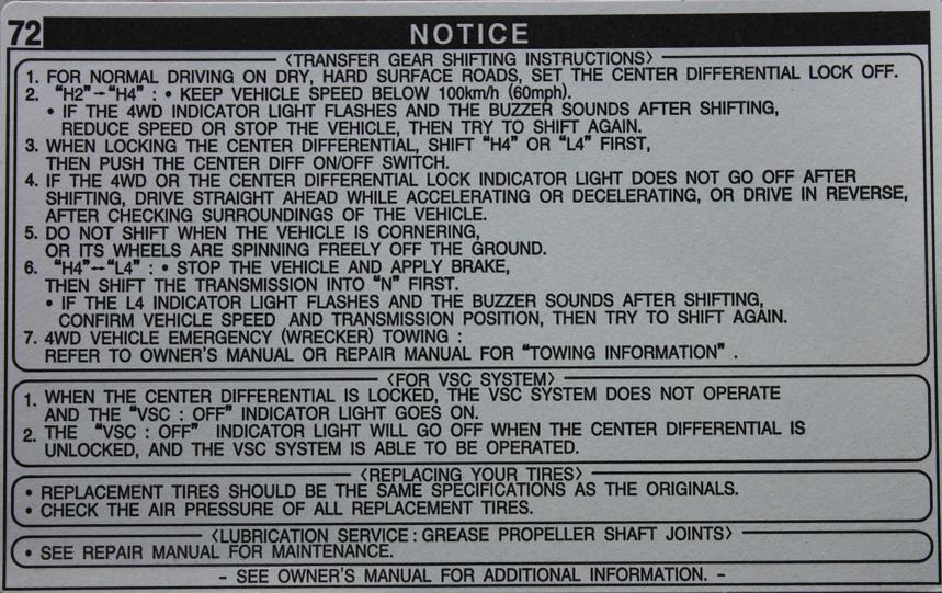

Locking the center diff will disable Trac system.

Not sure why this is so difficult. Just to be clear none of our 4runners are actually All Wheel Drive so when you lock the center diff you are just sending equal power to the front (open) differential and rear (open) differential just like you would if you have driven any old 4wd vehicle. My wife drives the 4runner because I drive old junk and when it snows she locks the center diff as should you unless you really cant drive and no it does not pull to one side but what it does do is have power when you need it.
The biggest difference is really TC or no TC.
This was at one time in your sun-visor pocket.
Seems like Trac/VSC control would be more sensible at highway speeds in slippery conditions.
