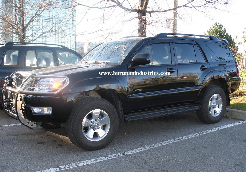

265/70R17 will work great with Cornfed Lift. Check out my 4Runner with 265/70R17 Bridgestone Dueler A/T Revos and 3" Cornfed Lift:
