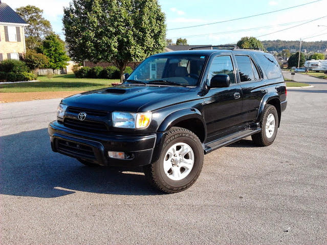

This is the same diameter as stock is it worth going down a rim size to gain a little sidewall?
Stock wheel size on an 02 sport is 16", unless the previous owner of your truck replaced the wheels with 17". I believe the later year 4runners may have moved up to 17", but the largest stock size on a 3rd gen is 16".
These are the stock wheels on a 01-02 sport edition.

OP, to answer your other question, no I wouldn't go down a wheel size just for more sidewall unless I was planning on really wheeling it, and then only if I was replacing the wheels for other reasons.
