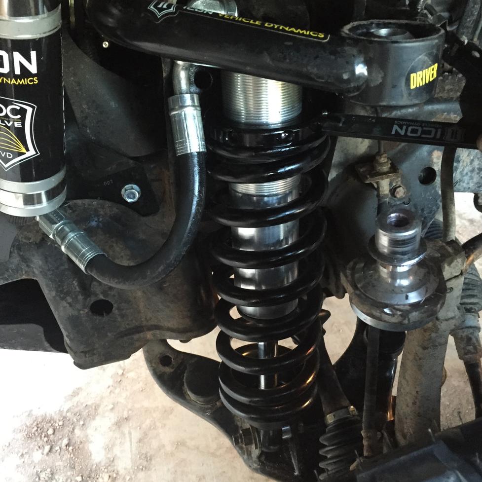

I have stage 2 with stage 5 fronts with the external reservoirs. Not going to lie, I got the fronts simply for looks. Stage 2 is perfectly fine for wheeling. External reservoirs are good if you do a lot of long high speed desert runs which I don't plan on doing.
a few pics. youll still get the same amount of articulation with a stage 2 extended vs other stages.
Are you still using sway bars with this much flex? Asking because I bought a stage 2 and that's a good bit of flex!
I have kdss so my sway bars are def still on. That might be another reason I have a little more flex/droop without long travel. Here's another pic.
