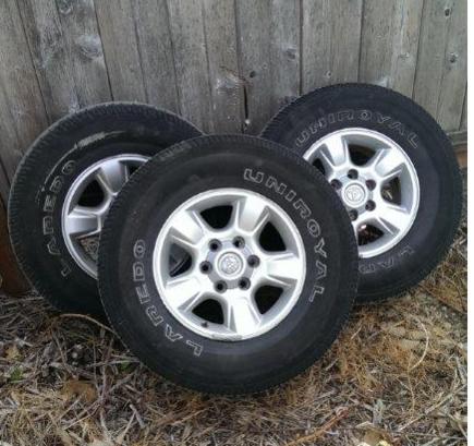

I want to get 16inch wheels so I can do the 231mm upgrade... but I want the truck to look period.
Which wheels would you suggest?
So Far I'm leaning towards these but maybe I'm missing something.
Your thoughts? All suggestions welcome. Even the goofy ones. :)

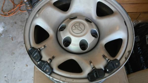

Yea, I've looked over that. I think these would work. Didn't see them "specifically" but I like the suggestion of Steelies. I bet there is the same amount of room inside any of them since the steel outer wheel determines the inside diameter.
EG... lot's of room.

I liked those 16" tundra wheels in your first picture, until I saw them on a 3rd gen. It just didn't look right.

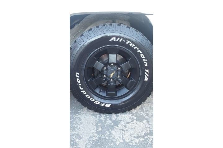

My favorite 16" wheels are the 5 Stars. Unless, of course, you consider the TRD wheels a stock option.

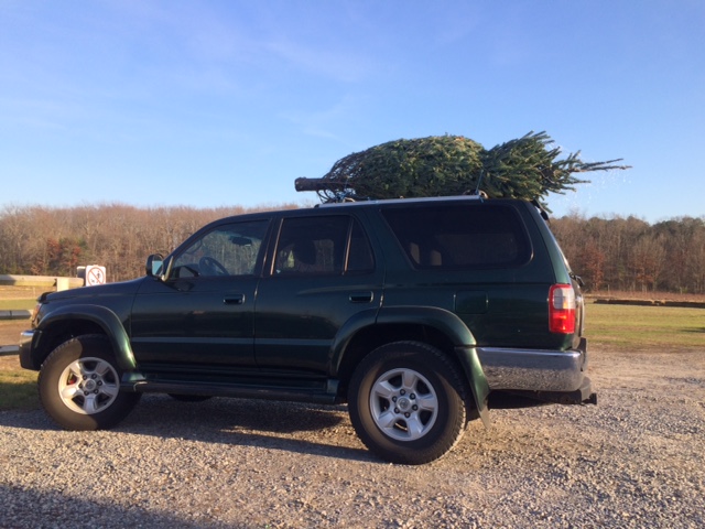

I thought these wheels looked cool before I lifted my 4Runner.

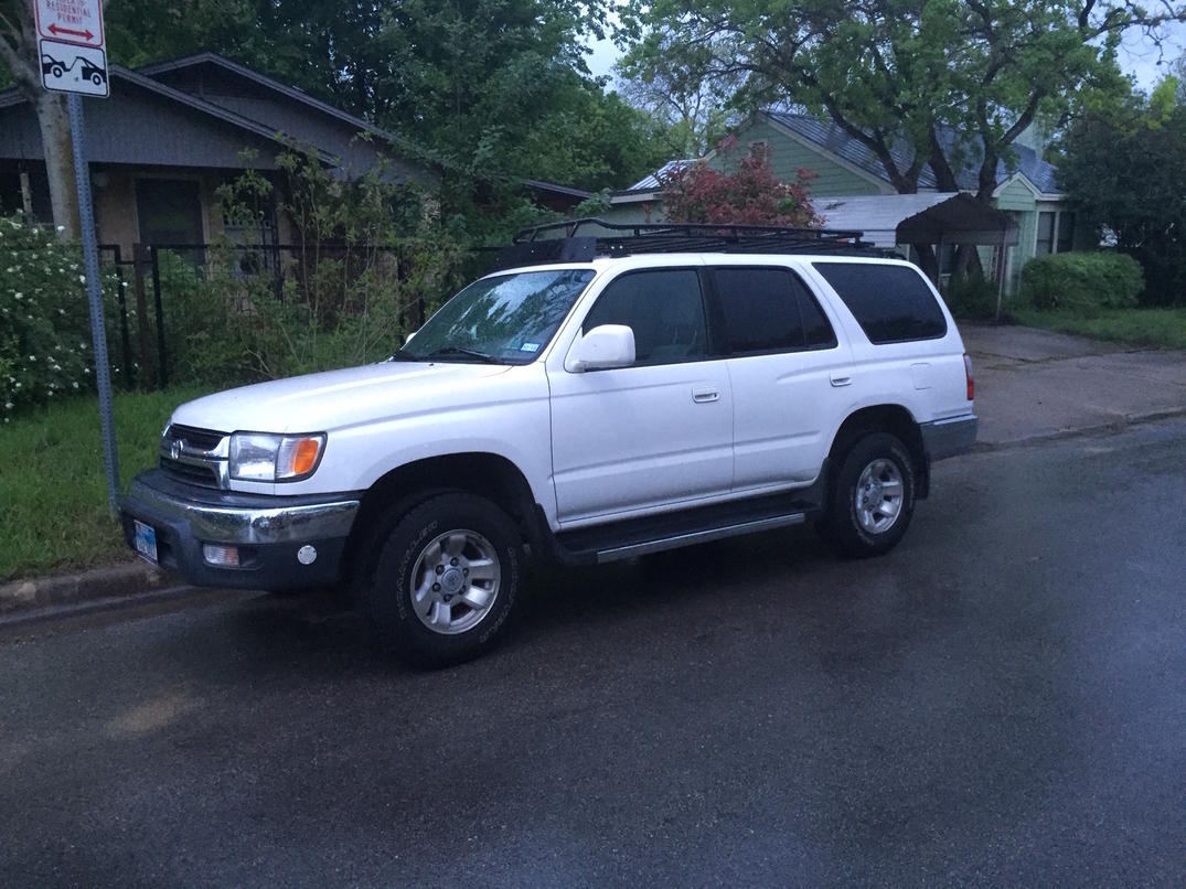

Here are those wheels in chrome. The day after I bought my 4Runner lol.

Here are those wheels/tire on my 1st Gen... RIP =(

I wonder what size brakes were on that 2006 tacoma with the steelies?
Can't seem to find the answer...
Stupid interwebs.

these are the 2004-5 Tundra 5 spokes as you have in the original post photo. I have them mounted over the 231 tundra brakes

These 16" steel wheels will not clear the 231mm upgrade without using wheel spacers. I did a 231mm upgrade on a customers 4Runner per his request and those wheels will hit the caliper on the outer most corner. Roughly 1mm of interference.
