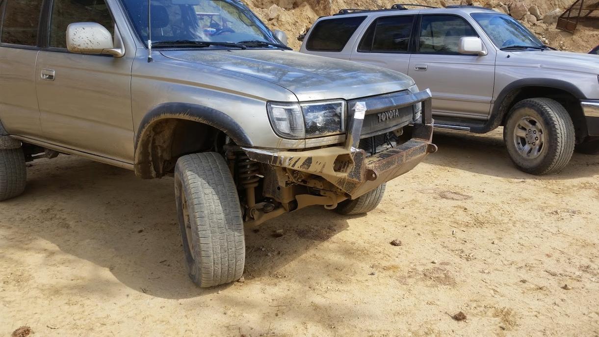

the main thing is to make it low profile so you dont have to hit stuff.
make the center strong and wings thin and add support to them with tubes.
