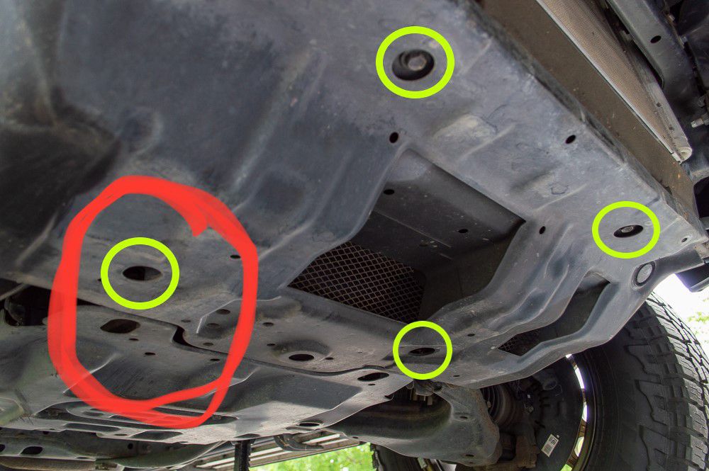

Need help :/
So i got a 2013 4runner SR5, one of my skid plate bolts (circled in red) does not want to budge at all!!!
I drowned it in WD-40 over night, tried loosening it with an impact, quite a few times and nothing, it actually cracked my 12 mm socket!
Any suggestions, or tips would be greatly appreciated!
Try SeaFoam Deep Creep instead of WD-40. It penetrates better. You will also need longer than a day of soak. Perhaps a week.
They make special sockets for impact wrenches. Much stronger.
There is an old saying: "don't force it, get a bigger hammer". In this case a bigger impact wrench or longer breaker bar. But of course, then you may break the bolt, strip the threads, or even rip off the frame part that the bolt screws into. Thus, it is best to keep after it with Deep Creep.
If the bolt does break, then your only recourse is to drill it out and renew the threads.
Many people, like me, have replaced the bolts with studs. Much easier to take the skid off for maintenance.
