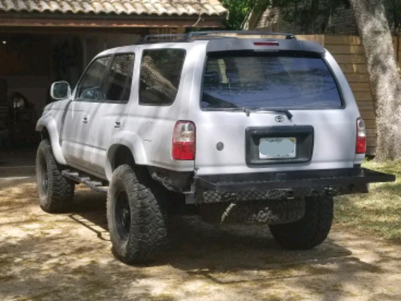

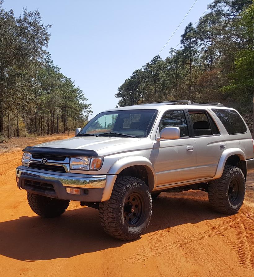

Also, FWIW, am effectively running exactly that: 16x8s with 0 offset (4" BS), wrapped in 285s.
