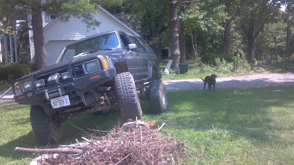

its a warn...but i think it may be a older style.
im going to be taking it off and having a look..
you can kind of see it here, i have no clue on what model, size or anything... i'll let ya'll know when i take it off.

it's a XD9000 warn winch...the guy that had it before me said he was using it and it quit. like shut the truck off and wouldn't let it start he had to cut the negative wire for the truck to work.....any ideas?
