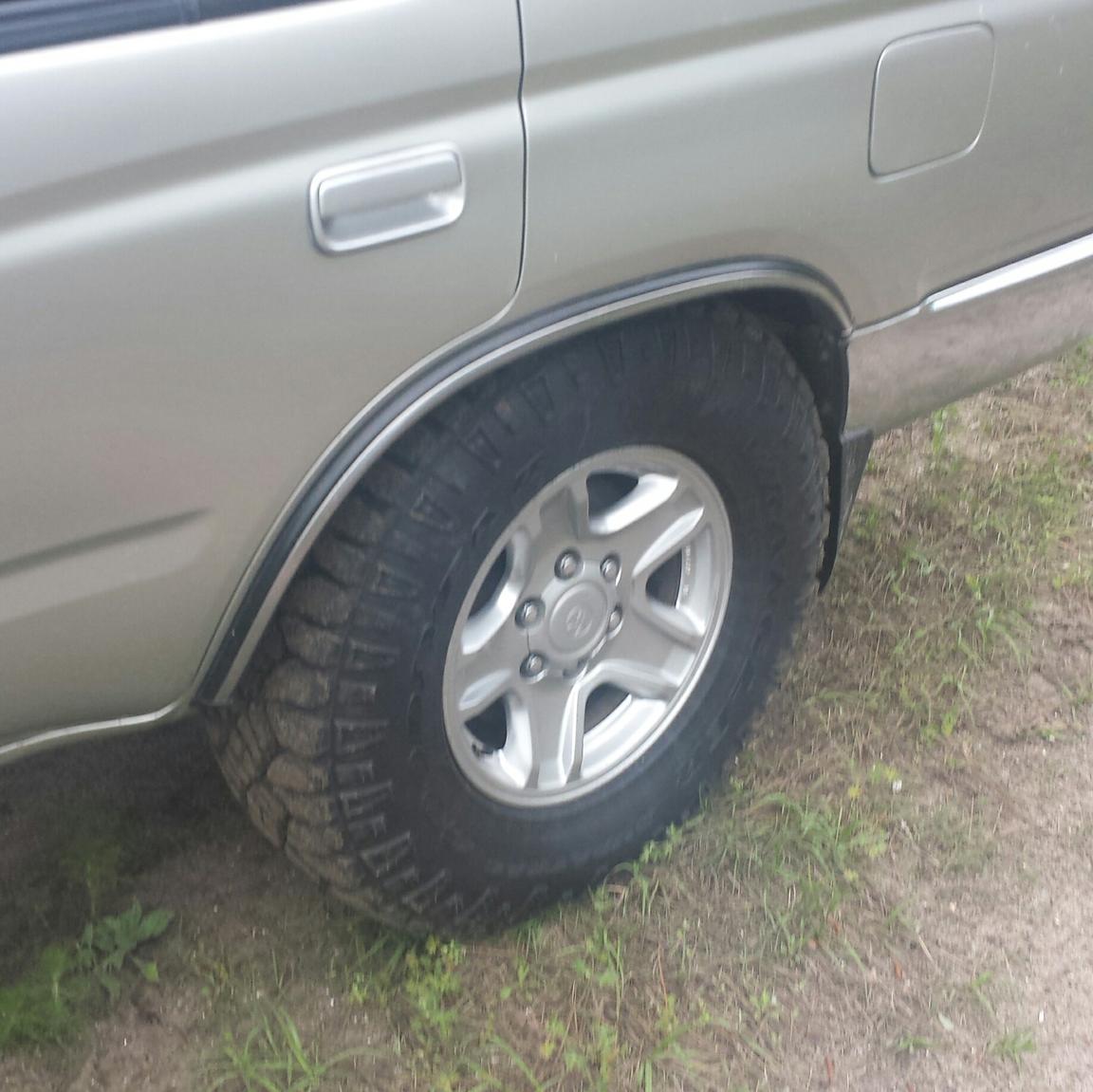

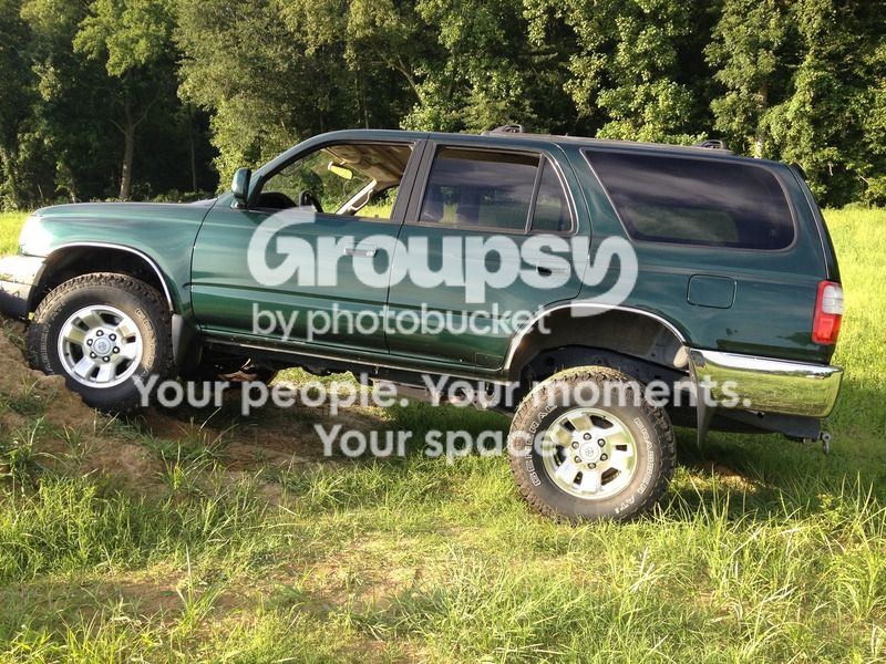

I have 265/75/16s and i feel like they are small with my 3 inch lift (lots of gap in the wheel wells) but good thing is i can stuff the tire really well and not rub. If I were you i would just buy the 265/75/16s and not lift it since you have the tall springs. It would look clean.

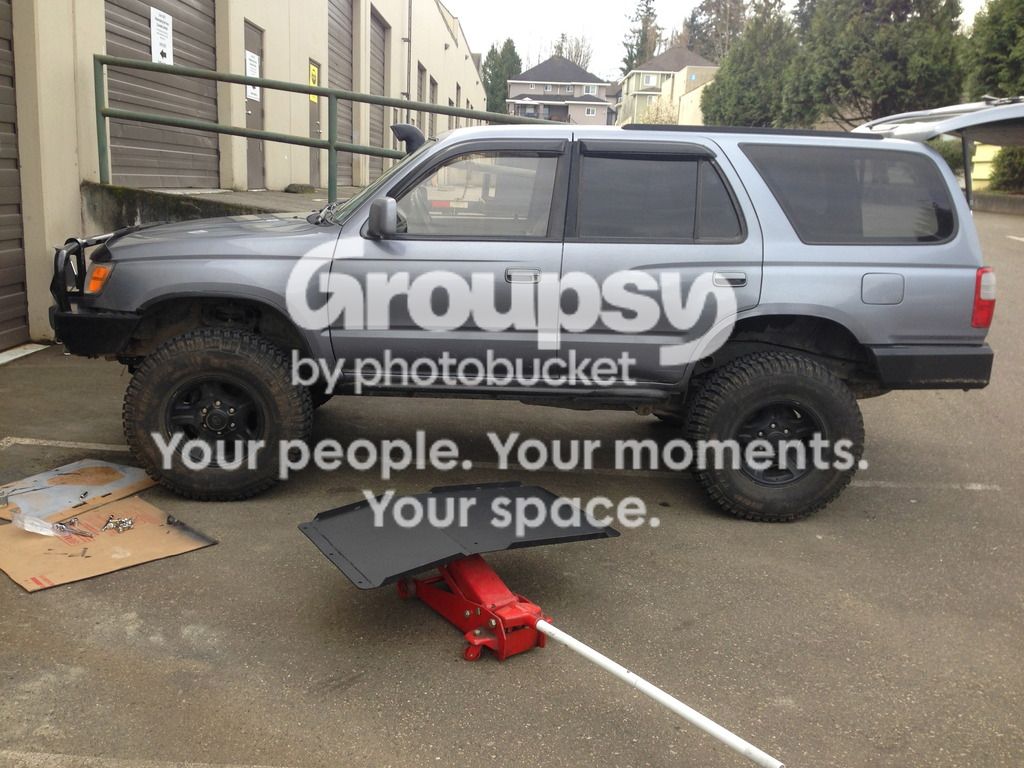

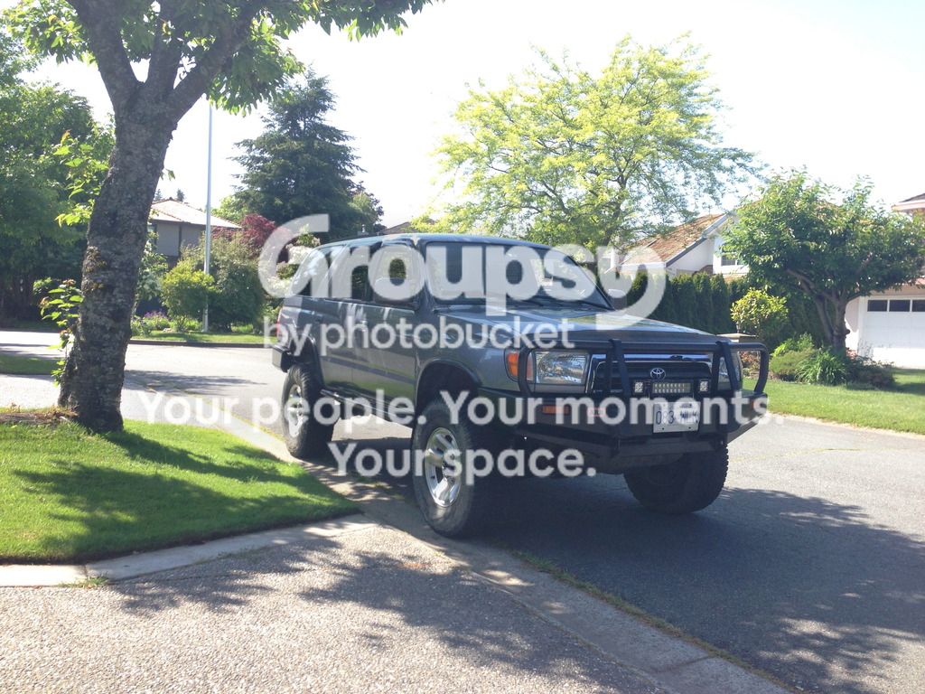

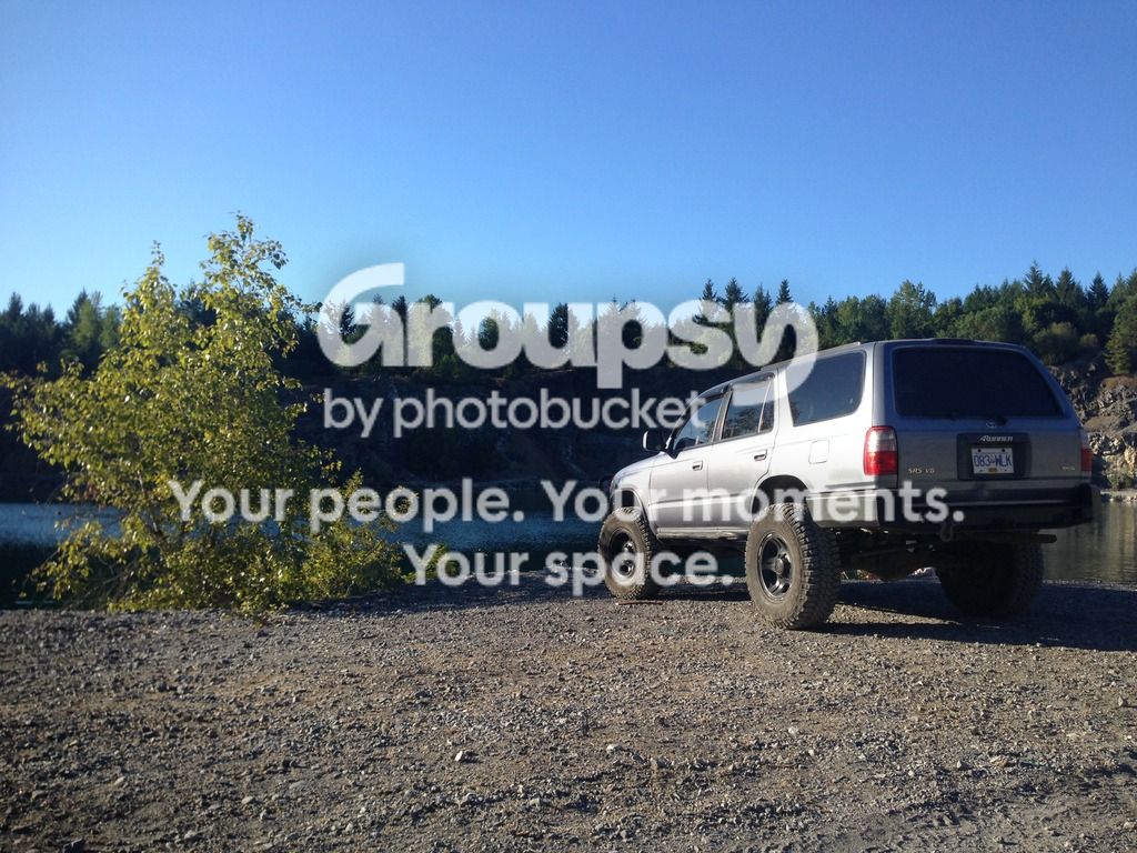

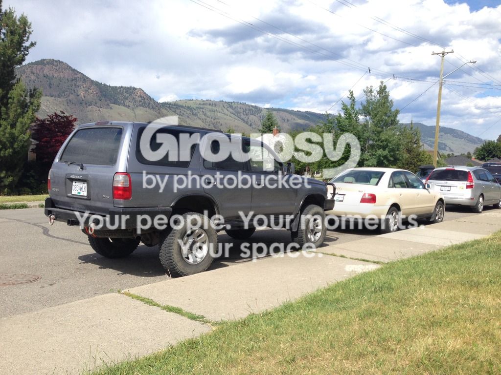

[MENTION=127668]19994Runner5spd[/MENTION] Here are some pictures of the 265's vs 285's. Same suspension set up (Stock Tundra Coils with 5100 Bilsteins and land cruiser shocks with 7.5 wrap coils). With the 285's, I have the added weight of the winch, skids (except the one on the jack obviously) and full size spare tire so the suspension is slightly lower. With the current setup Im at 2.5" front and 4" rear. With the 265's, it was more like 3" front, 4.5" rear.
The wheels make a huge difference appearance-wise. The stock wheels with 1.25" spacers and the 265's always looked too narrow with the lift IMO. The 285's are on land cruiser wheels and I left the 1.25" spacers on to clear my 231mm tundra brake calipers. They give a way wider track and a more aggressive look
265's
285's
