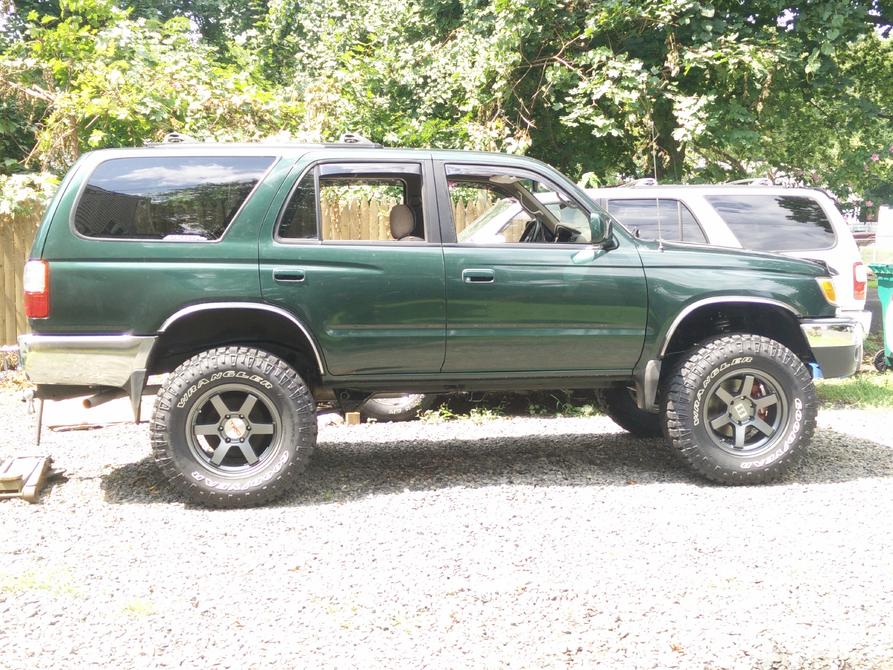

Here are some recent pictures of mine
http://www.toyota-4runner.org/3rd-gen-t4rs/178792-chuckles-98-manual-sr5-4runner-21.html#post2086210
http://www.toyota-4runner.org/3rd-gen-t4rs/178792-chuckles-98-manual-sr5-4runner-21.html#post2086216
http://www.toyota-4runner.org/3rd-gen-t4rs/178792-chuckles-98-manual-sr5-4runner-20.html#post2068072

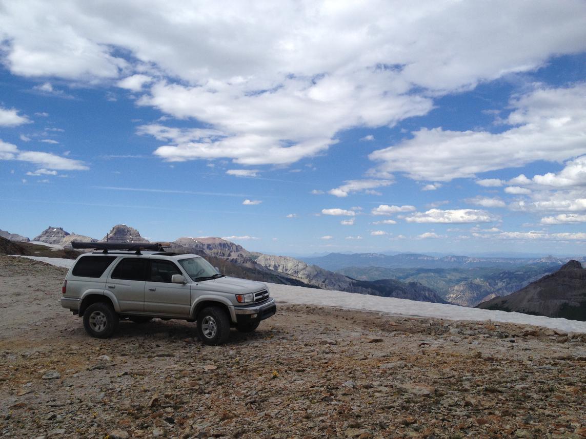

I have a 2000 4runner with the same 5-spd and open 4:10 rear. I installed the 99 talls with Bilsteins and firestone airbags about a year and 15,000 miles ago. I highly recomend the air bags. The combination has been able to get me to most places I've wanted to go, and with no sag when loaded with gear. Considering I'm married to the glamping queen that's saying something.
I too hope to find a locker some day, but since this is my daily I hesitate to take it much further. My truck has a VERY compliant ride, and I consistently average 21-23 mpg. I'm not sure why my fuel consuption is so good!? As far as fuel tank size, if I spend an extra couple of minutes at the pump I can easily get an additional two gallons in the tank, bringing my range to around 350 miles.
All said though, if this wasn't still my daily I'd probably like to add another couple of inches in ground clearance, just in case. Picture was taken at Imogene Pass about two weeks ago.
Nice looking 4Runner! I can believe those mpg numbers. The 5 speed seems to make a big difference in fuel economy
