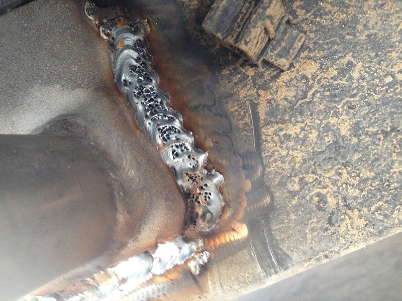

What would you do with these welds?
I would ask for your money back. Then take your 4runner to a local technical college and find who is the best of the class and pay him/her to fix it.

I'll echo what others have said: looks like the gas was off, or he ran out, or he was welding outside with MIG and it was super windy.
Either way I would not trust that for anything that might bare even a little weight.
Would it be ok for a BBQ pit that just going to get smoothed down and painted, sure, but if I laid down those welds (even on a BBQ pit) I'd redo them.
Get your money back or have them redo it.
holy under cut/cold lap batman. major major screw up. if you did these welds grind them down, do a root and cover pass with better air coverage and arc length. if you paid money for these, you were pretty much robbed. you have got to fill the joint with sliders as much as you can, the last thing you want is for your sliders to not slide and bend into your doors. as someone had mentioned earlier I would not worry about the top, you probably cant get the gun up there even if you tried. I did my sliders with a $150 flux core machine with a 20% duty cycle in my driveway, while I had to sit on it for a while so that it would get hot enough to form a puddle, they were a lot deeper penetrated that these. (P.S. never buy a $150 welder because you WILL get what you pay for)

Weld from a Denver area Toyota "shop" that claims to fabricate and build crawlers:

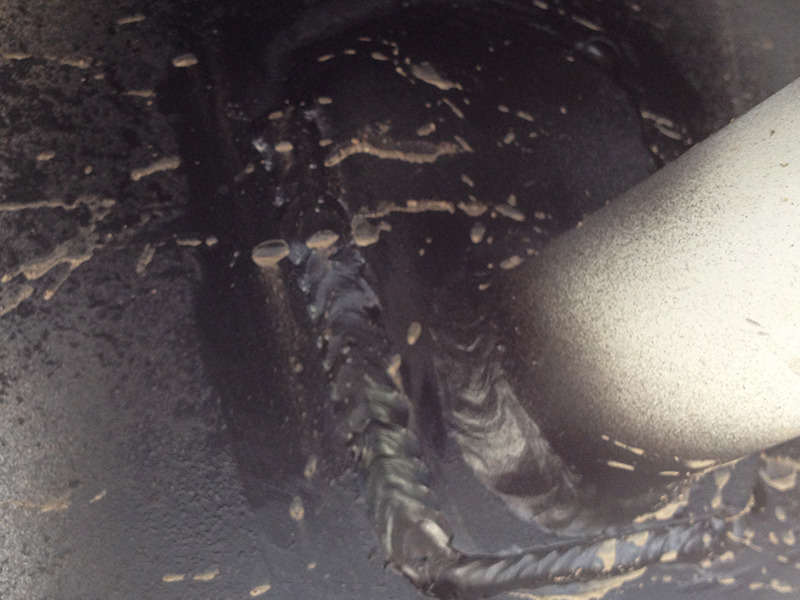

Welds from Addicted Offroad after they fully ground out all of the hack job work:
I can't say enough good things about Scotty and his team over there. All of the plates are fully welded, consistent, and defect-free. There is such a difference between a real fab shop / welder and someone who claims that they can weld.

To fix this, the guys at Addicted cut the slider off, fully ground down and fixed the old welds, ground the plates smooth, added even more mounting plate for the new location, sleeved the slider, and fully welded the sleeve and remounted the slider to the plate. This was a crazy amount of work just because I wanted to save myself the drive and save a few buck having that local "shop" do them.

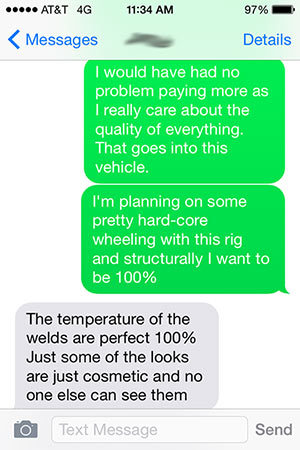

Also - here is one of the messages from him defending his work... (I also hate doing any business with texts - he never answered the phone)
if you paid with a credit card you can dispute the charges. if needed, show them pics of your welds vs proper welds and supporting opinion of certified welder.
