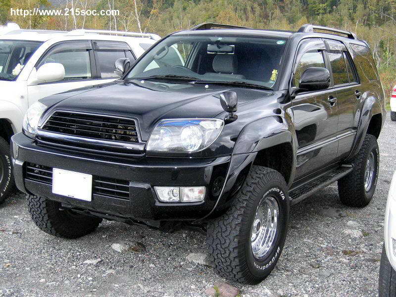

I haven't done a whole lot of research, but no one has mentioned the BFGoodwrench All Terrain T/A. From some of the pictures I've seen, they look pretty rugged. Any opinions? Do they come in 265/65/16?

They're great. This is my second set.
