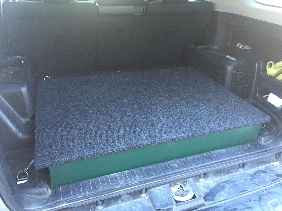

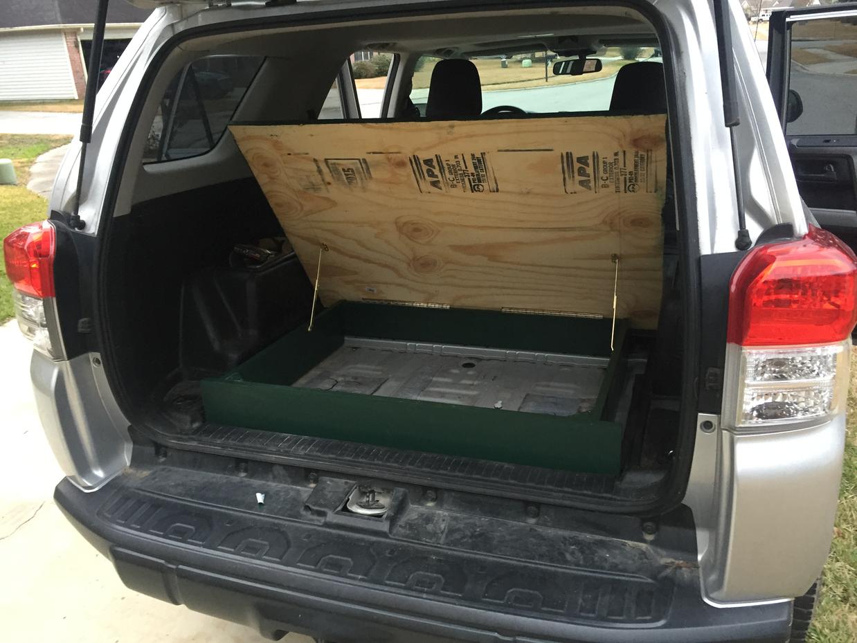

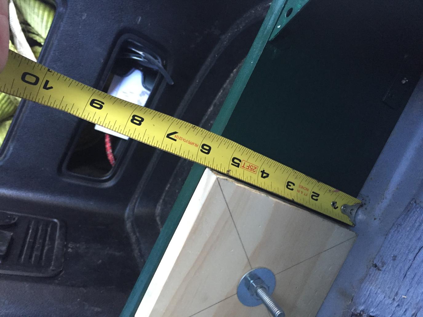

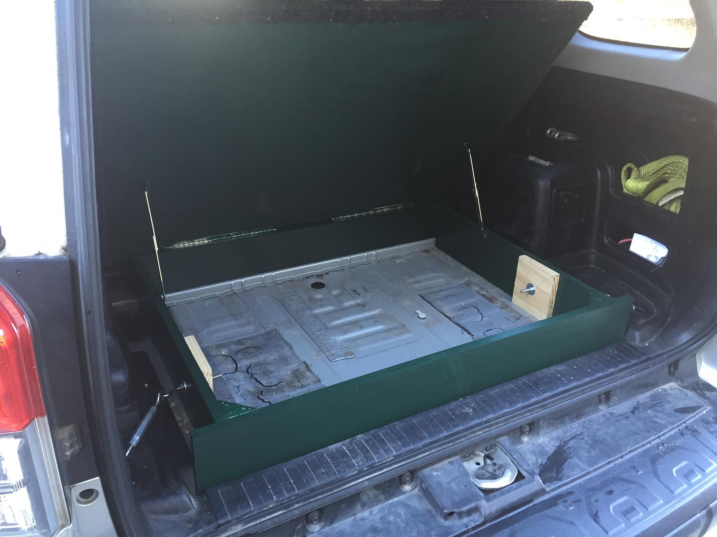

I pulled out the sliding cargo tray and built a wooden box, I "lost" about an inch and a half of vertical open space but gained a 5inch vertical storage space. Great for recovery gear , first aid kit ect. Couldn't tell any difference in road noise after installing the box. 1in pine frame, piano hinge on 3/4 in plywood deck. All sealed with a waterproof paint and upholstered with outdoor carpet.
