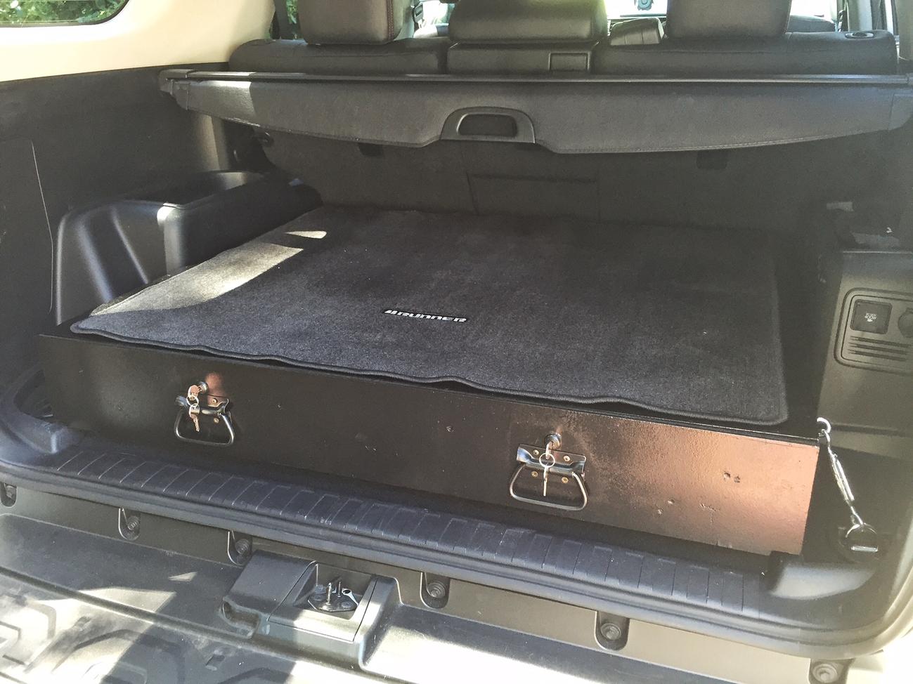

Not mine...built them for a fellow member.

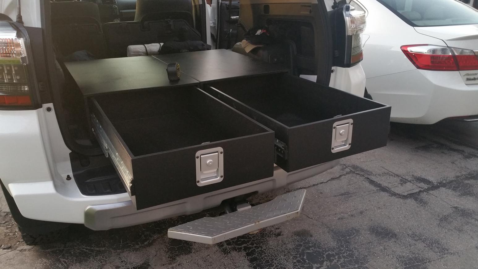

Here's my take in beta form. I've got some additional plans for the front of the unit and a slide out cooler mount on top.

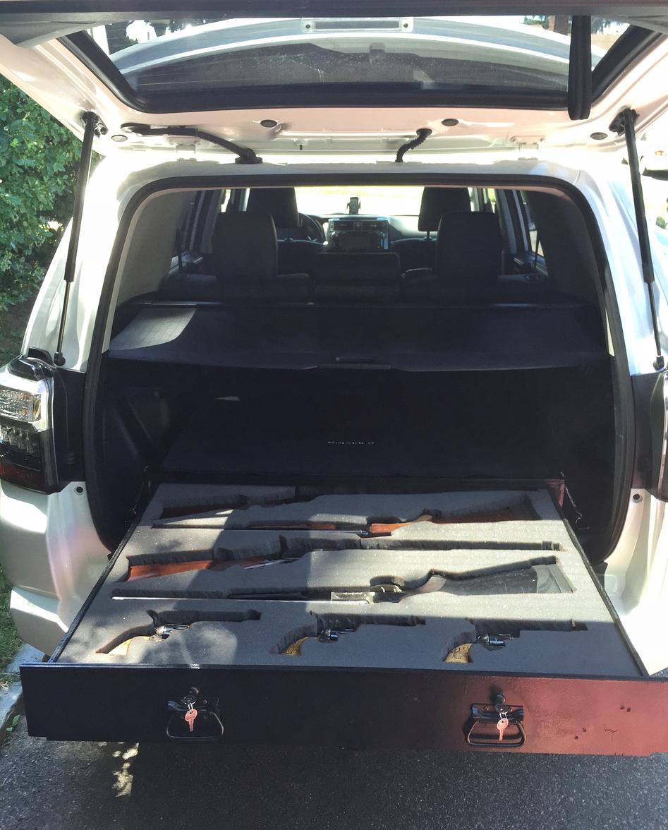

I did not want to spent the $$$ on truck vault, so built my own. All the materials cost me $200. 1/2" plywood, heavy duty sliding rails (online), couple of handles & locks + foam insert for whatever you will put there
I'd like to copy what you did. Do you have a source list for on line materials and perhaps some build pictures?

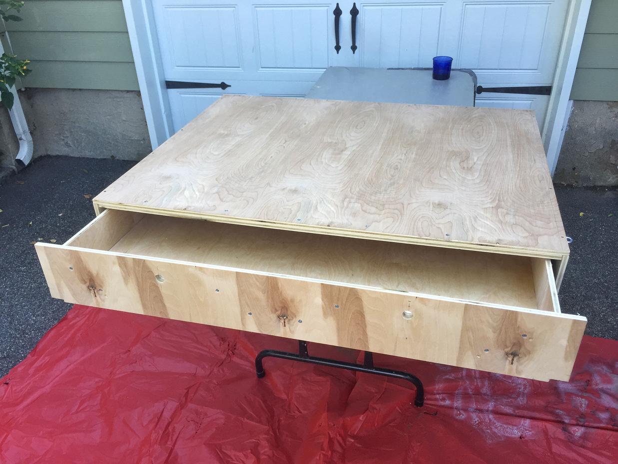

Materials
Sorry, but I don't have too many work-in-progress pics. I attached 2 I have
Most of the materials I purchased online
Home Depot
8 x 4 1/2" plywood. $40
4 eye-to-eye turnbuckles. $8
Black paint
Online
2 heavy duty 32" drawer slides. $35 to $45
2 chest handles. $10
2 keyed locks. $22
Foam. I am using double layer 1.5" on the bottom and 2" on top for cut-away. I think I paid $50, but only used 1/2 of it. They came in a large sheets
