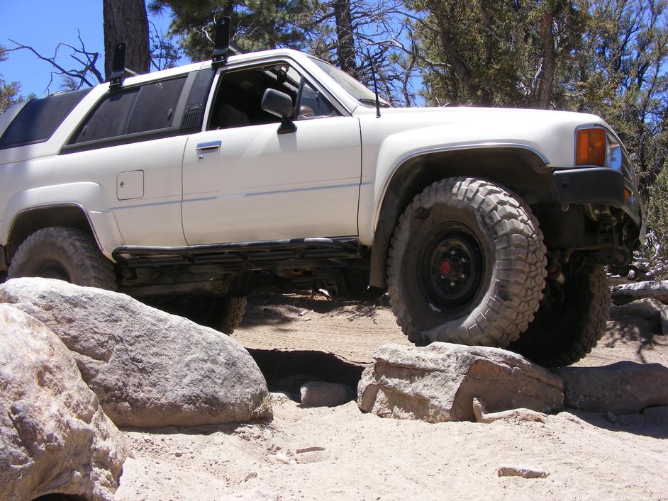

The biggest tire you can run on the stock 15x6" wheel is a 33/10.50R15. I've been running this setup for years. Do the 'pinch-weld mod' where you hammer(not cut)flat the pinch weld at the back of the front wheelwell.
Thank you! Does that preserve full turning radius?
Also, do you know how a 33" affects mpg? What do you get?
You're welcome. It'll rub a little but only at full lock. Nothing to worry about. After I installed some ball joint spacers it's not an issue. I'm SASing it now so it's a moot point. Running 33s will definitely affect mileage if you don't regear. Forget about using 5th unless you're headed down the mountain! 33/10s are a lot lighter than 33/12s so that helps too. As for mpg, I'm not sure. It's not my DD sooo... :noidea:

I was having some scrubbing issues with aftermarket steels, even with bj spacers. Went back to the OEM rims and solved the rub on 33x10.5.
