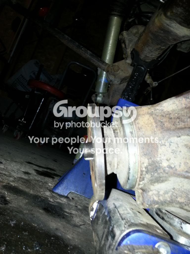

trying to figure out what type of rear diff i have, its a 4cylinder 4runner but the gears i ordered for it are not fitting properly and was told it might be because i have a 6 cylinder diff. I counted the OEM teeth, the pinion has 10 and the ring has 41 so i assume that makes it a 4.10? is the v6 and 4cyl diff gear ratios different? anyway i can find out which one i have??
This is the issue i am having:

I told them (Trail gear) its a 97 4runner and they asked if it was for a v6 or 4cyl being there different parts, so i told them its a 4cylinder. I didnt order an install kit from them, but last year i ordered a spool from a different shop and got the install kit from them. I tested it out with the gear paint, it lines up perfectly, only issue is that stupid pinion sticking out too far from the back

I had the diff fully assembled with the 4cyl gears and they fit perfectly beside the back end of the pinion sticking out too far. i guess it would work if you cut 1/4 inch off the back of the pinion or halo out the inside of the drive shaft so it sits flush. But i think its much easier to just NOT order from Trail Gear and get the proper ring and pinion. They didnt even apologize at ALL and were kinda doochy about the whole situation, stupid goofs, all the shops in Canada are pretty much like this
