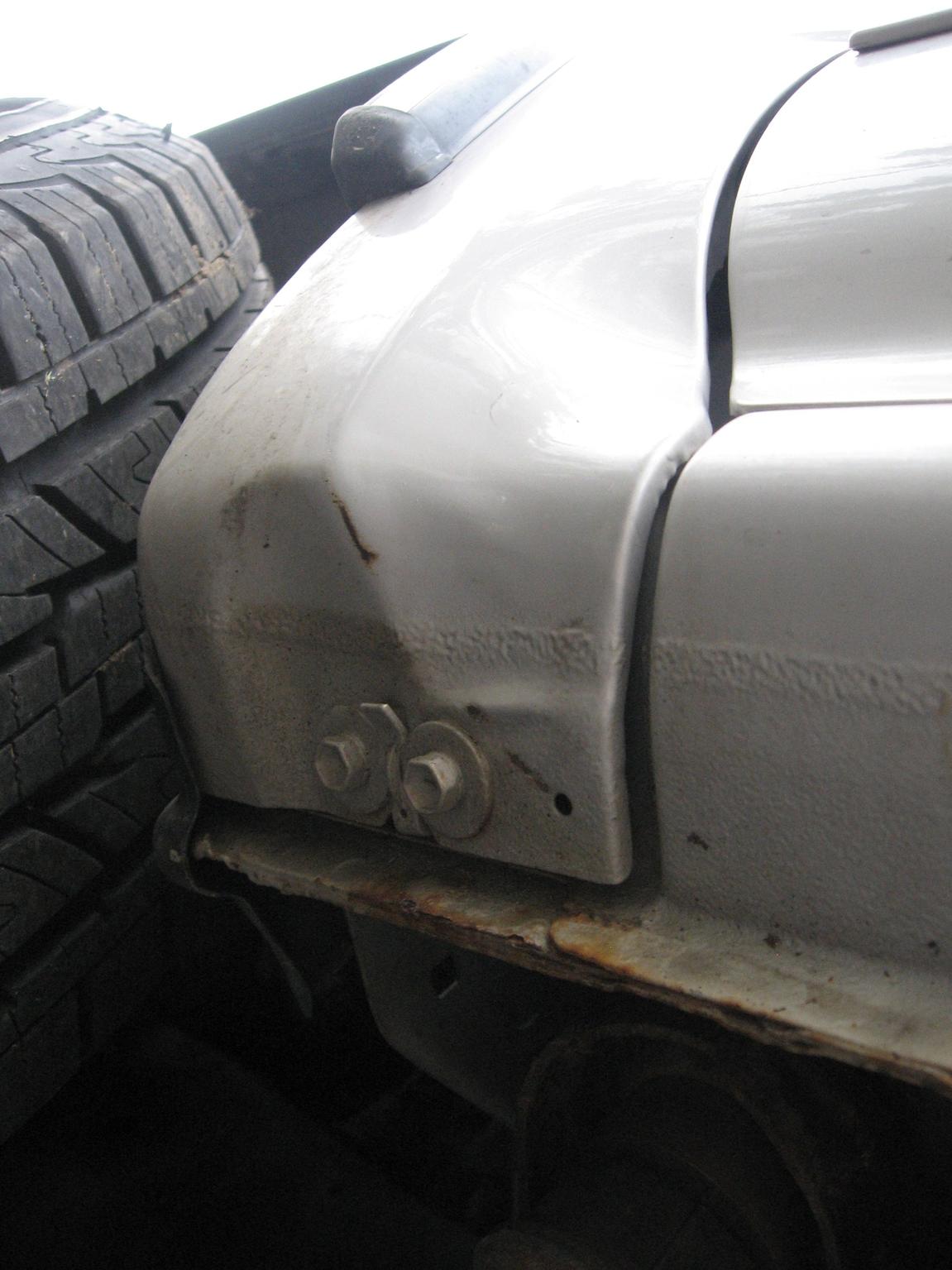

I had my truck on the lift yesterday & did a full rust inspection. The frame is solid with just surface rust. There is flaking at the welds everywhere that will need to be wire brushed & POR 15'd. I took the running boards off & some paint has been scraped off by the plastic moving around. (see pic) My rear axle has deep surface rust that needs to be attended to immediately. The pinch weld under the body & above where the running boards go is bad in one spot. It looks like moisture got trapped in that area because of the running boards. (see pic) I will have all of this addressed before the winter. But overall it's in very good shape for 16 NY winters
I just drilled a 3/8” at the lowest point I could find near where those screws are on yours. Then opened my door and hoses out the packed up mud that had built up inside the rocker panel. Then sprayed it thoroughly with fluid film.
It’s a little bit of a scorched earth approach but better than what was going in - with one tiny drain hole that plugged with mud.
