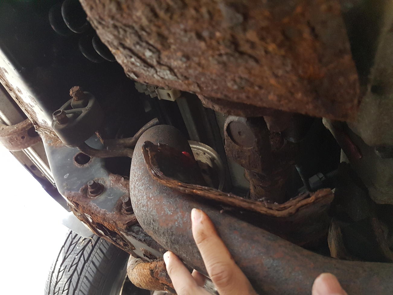

2004 4wd are v6. It looks like a dust shield/skid plate protecting the rear end of the front drive shaft. It rusted and is sort of touching the exhaust pipe beneath it, probably causing the intermittent rumbling sound at very low speed.
Does anyone know what part this is and the part#? Also the bolt holding it in place. Thanks!

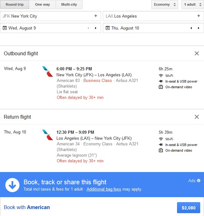

Well actually that depends on your budget and if you can get to JFK by 6pm tonight... :D

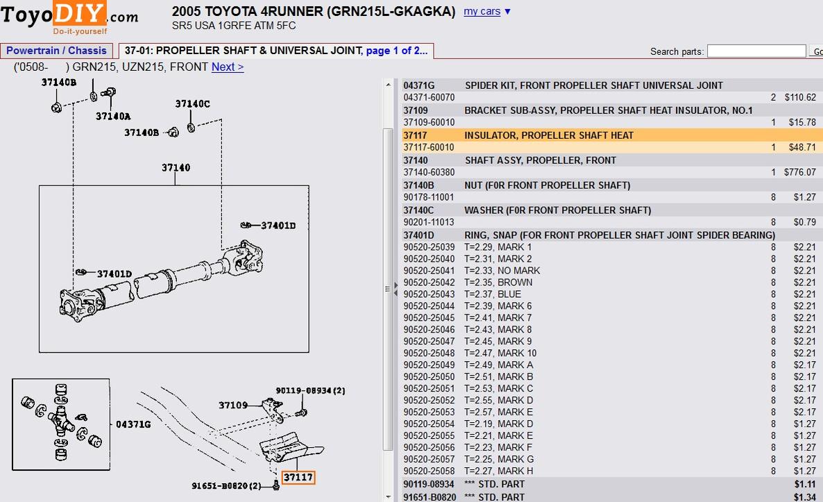

It reduces heat exposure on the universal joint. High heat can thin the lubricating grease and reduce the operating tolerances in the joint, which will produce excessive wear over time.
Wow called the dealer and they say there's only one in the country and it's in California so no hope of getting it tomorrow...
That's not true at all. I'm in Georgia and there's one on the 4Runner in my garage. :-)
But seriously, it is indeed a shield for the driveshaft. Took mine off to access one of the zerks last time I greased it. Wear eye protection if you remove it, there's all kinds of grit and gunk that falls when you move it.
