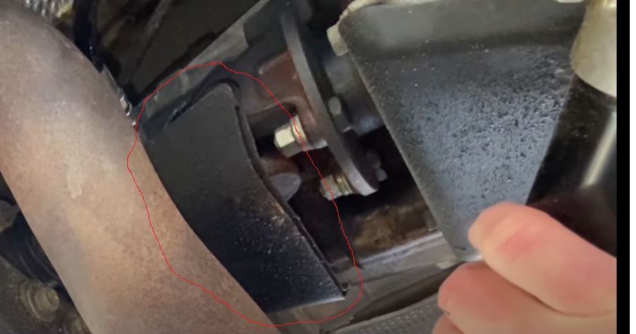

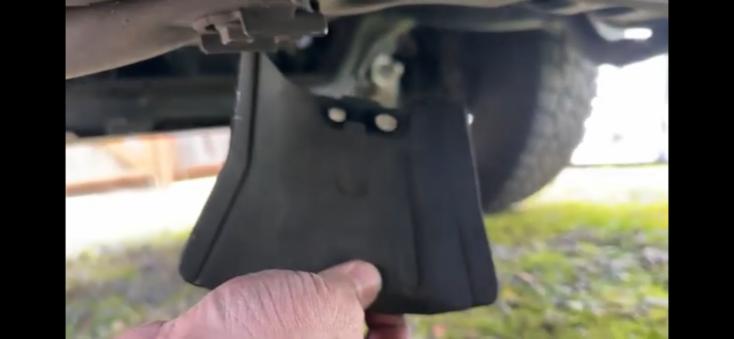

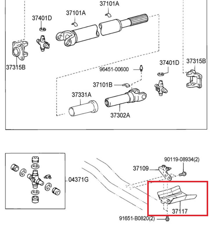

I have a 2006 4Runner Sport V6 4WD. I can’t find the part number to this piece that looks like a heat shield protecting the propeller shaft where the 2 zerk fittings are on to lube it. Mine broke off due to rust when I was using the grease gun. The exhaust runs directly underneath it. I found drawings on a Toyota parts site but cannot find it as a legit part using the number in the picture (37117). I included a picture of a screen shot from a part site and a screen shot from a video showing someone holding the piece I need!!

The dealership is closed on the weekend when I broke the piece. I was hoping somebody who is lurking on this forum would know so that way I can have an idea of how much this part is before calling the dealership.
Yes I am planning on going into the dealership tomorrow in person to the parts desk. I was just trying to do research before doing so because the dealership here in remote Canada sure likes to charge a premium. I will have to show them the photos in my post to be sure they order the right part.

INSULATOR, PROPELLER SHAFT HEAT
37117-60010:wave:
