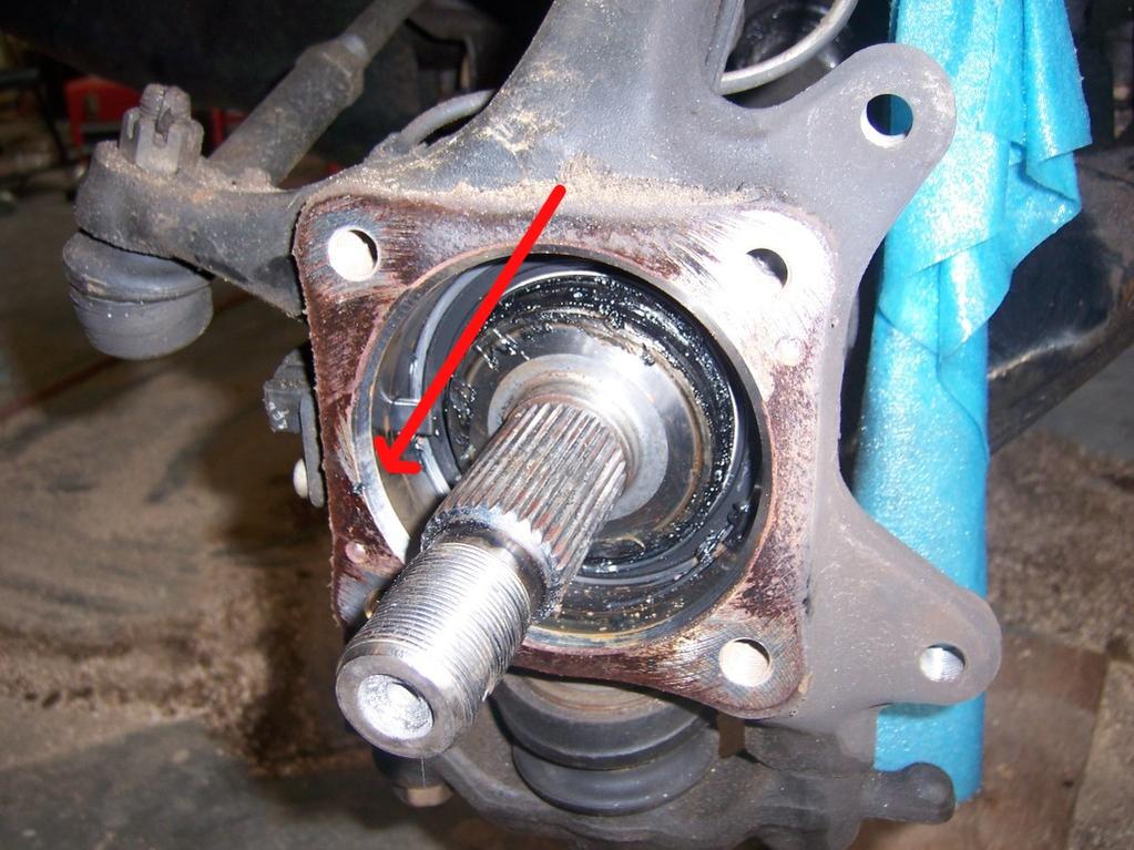

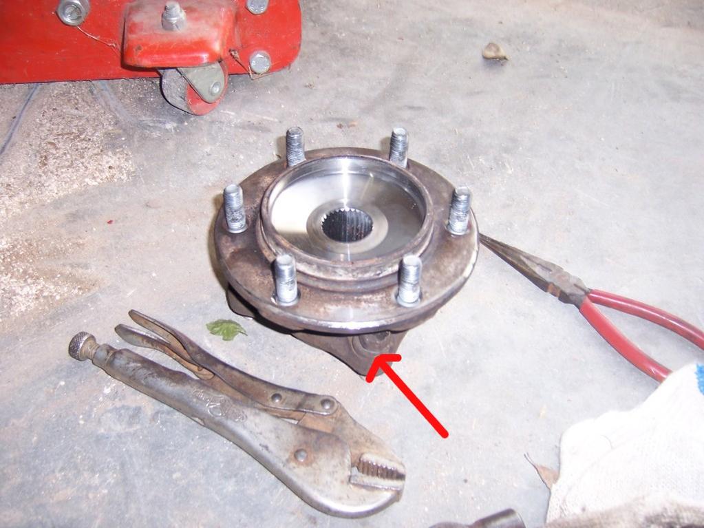

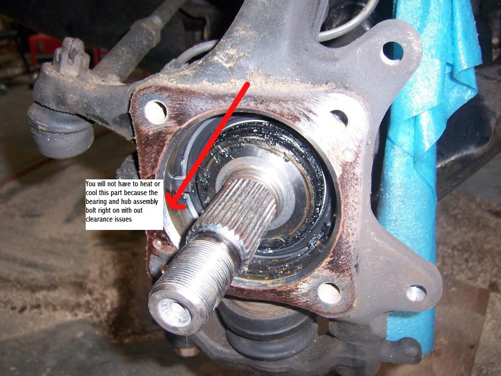

Could you elaborate more on what you headed and froze. Doesn't the bearing slip into the I guess you would call it knuckle or assembly?
The first picture shows the entire bearing housing. Did you replace this?
The second picture shows where the bearing slides in. Is this the part you froze?
Thanks

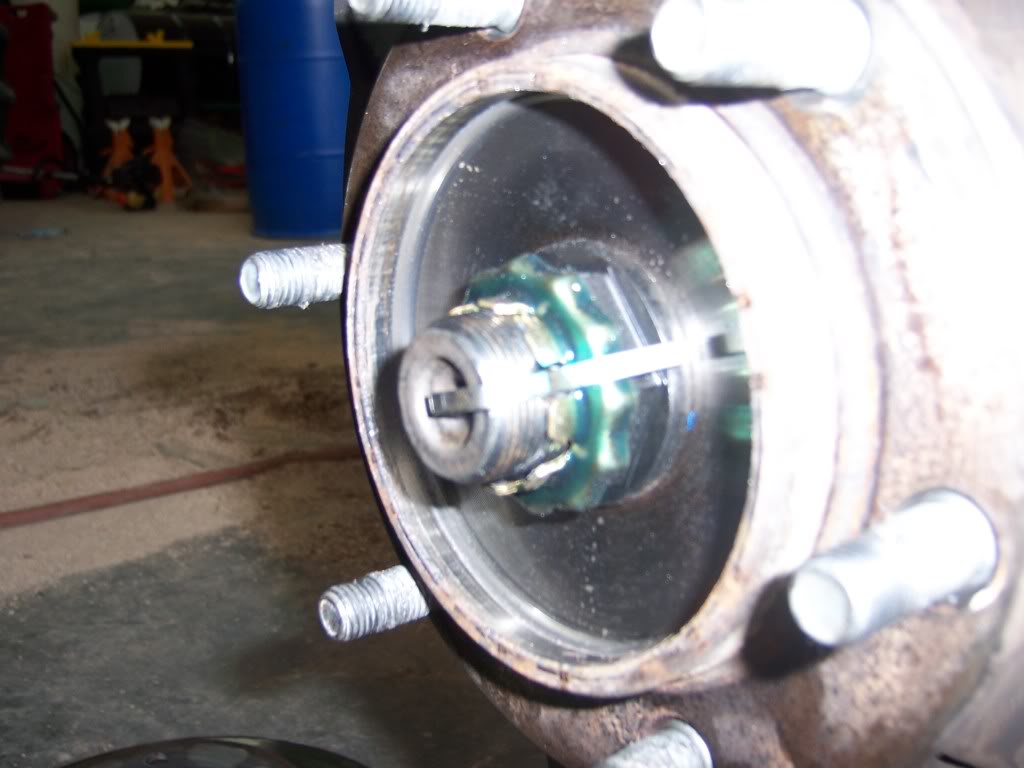

A few more questions.
What size is the axle nut?
What temperature did you take the bearing up to?
Thanks!

Thanks for the response, I am talking about removing the bearing from the knuckle not the bearing from the hub. In your picture you show a 3 jaw puller pushing on the axle shaft. How much force was needed to break that loose? The reason being is that the FSM shows pulling the knuckle and then pressing the bearing out before you seperate the hub from the bearing which you obviously have to use a press.
The way you did it using the 3 jaw puller looks eaiser than pulling the knuckle, but I am afraid of messing up the axle shaft using it as leverage. Another option I thought about is using a slide hammer. I just don't know how much force would be needed to yank it out.
