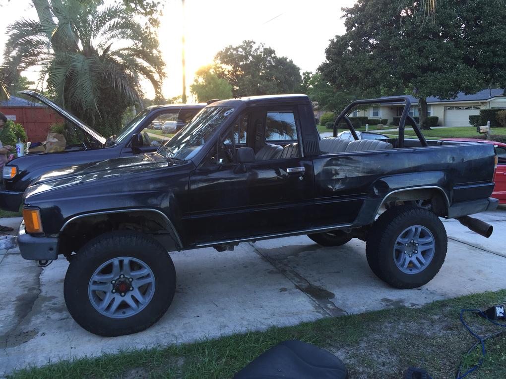

Im pretty partial to my Sequoia wheels, 17" rim, same backspace, same track, cheap and easy to get. This is with 33's and gently cranked torsions and 2" rear OME springs
