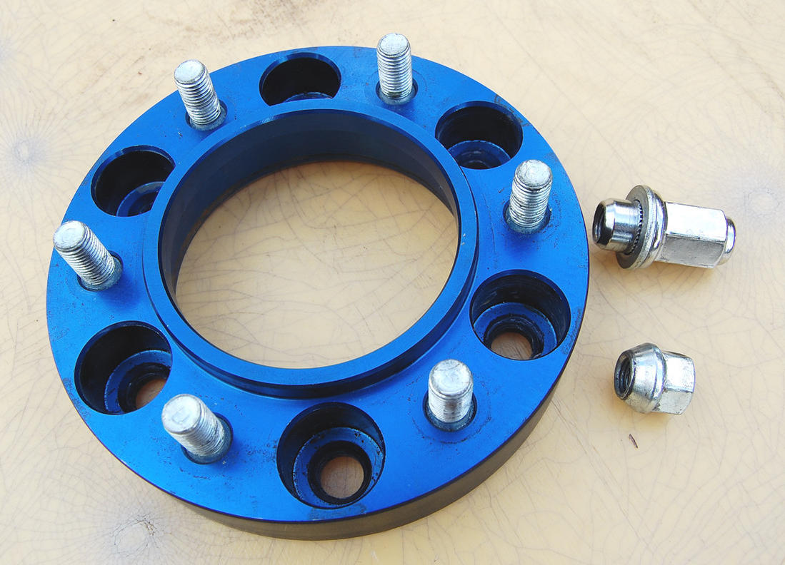

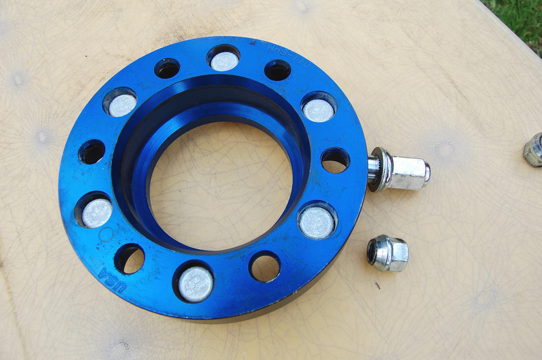

Here is another option for you all. Spidertrax spacers are hub centric on the outside where it bolts to the rim and hub and lug centric where it bolts to the axle. You could bolt it on the hub on your trailer and it has a hub centric outer to match your TE rims. They cost $99 a pair though and are 1.25" thick. Here are a couple of pics for ya.
It comes with the smaller tapered nuts in the pic. The bigger lug nut is the right one for the TE rims and you will have to buy them or ask Demeaux if he will sell his.
Toyota Hub Centric Wheel Spacer Kit
