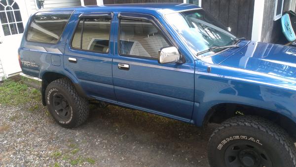

I have very general auto parts store matte black. It turned out pretty good.
Home Depot Rustoleum Self etching primer and Rustoleum wheel paint.
The biggest part of the ultimate success is to get all the crud and corrosion brushed off the wheel. A 4 1/2" angle grinder with a cup brush really works well. The cost is pretty low so if you scrape on something, touch up is easy.
