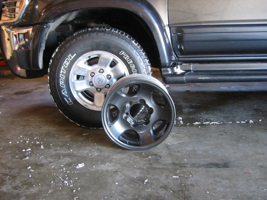

I painted a set of old Land cruiser rims with charcoal metallic and its been holding up well.
I just scuffed them up really good with a red scotch brite pad. Degreased them very well and painted them. No primer at all. Talk to my body shop friends and they actually told me not to use primer. Seems to be working great.

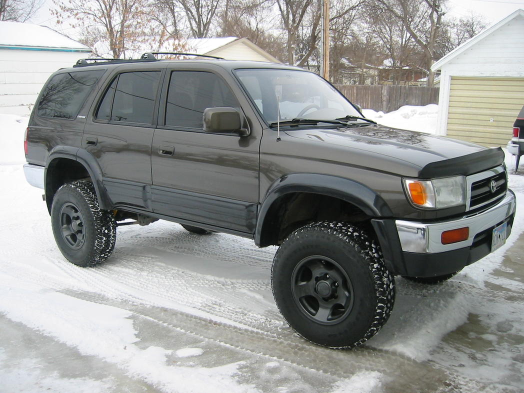

Clean them really good. Use laquer thinner to degrease, scuff with a scotch brite pad. Degrease again, let dry. Paint several light coats with Duplicolor alloy wheel paint until it looks even. Worked really good for me. These where American Racing rims that came with a clear coat.

ryani, why no primer? I'm probably going to paint mine soon and would love to not spend money for no reason. Rims look great, by the way. Sorry to hijack, but do you guys recommend flat black, satin, or high gloss?
I scuff sanded with the scotch pad, then I used lacquer thinner and it made the old finish soften. If you use LT for a degreaser, wait a bit before you touch them cause you could leave a fingerprint in the old finish.
Then I sprayed with etching primer then sandable primer then Duplicolor WP102 Graphite.
Masking off the tires was the worst part. Took forever to do it right.
I didn't have any places that were down to the aluminum.

I'm not sure why no primer. My friends at the body shop it wasn't needed for some reason. I guess if they get beat up they will be easy to touch up. Just grab the rattle can.

ryani - the wheels (and your rig) look good. Wish I could score some land cruiser wheels for cheap.
Brutus - Yours turned out really nice. That's almost exactly what color I was thinking about for mine. Do you have any pics of the whole truck with the wheels painted?

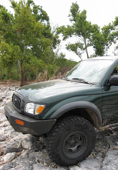

I painted mine with Duplicolor Bedliner and couldn't be happier with the results. I just cleaned the wheels up and sprayed it on. I didn't prep them too much because I noticed that even light sanding destroyed the finish, so I didn't bother. The bedliner has adhered really well in the past and gives a nice textured look.
I can get better pics if you feel like bedliner is a direction you'd want to go in. These are just some I snapped right after painting them.

Hey I'd like to see a couple of closer shots of that bedliner finish...and I love that avatar! :beer:
I took a picture of the worst wheel. I did a quick tape job and accidentally taped a little of the lip of the wheel, so it needs to be repainted where you see silver. The rest gives you an idea of the expected result, though. I love it.

Nice tires durell. How do you like the Kuhmos? I have the same tire and they seem to be wearing well.
I had the same tire on my Xterra and it wore well also. I did have some concerns about the wear, but in hindsight I think that was related to the lack of a wheel alignment after I got the newer (much larger) tires. I like them a lot on the 4R. They're 265/75's so they look a lot better than the other tires I had.
NICE!! I love the texture of those! wonder if theres one a bit blacker with that kind of look?
