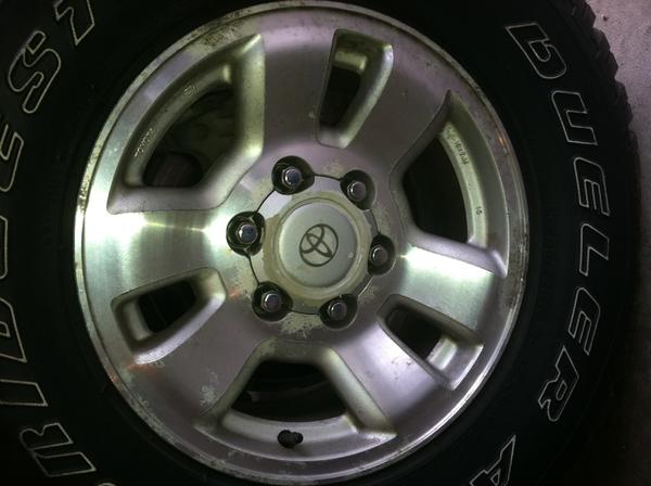

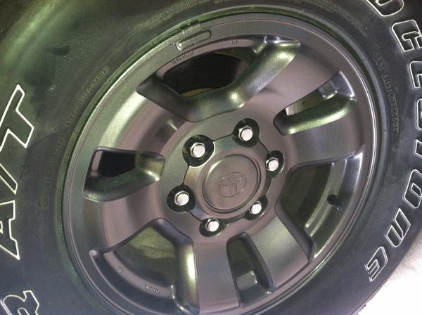

I agree the prep is the worst part, but 2-3 hours per wheel?!? I did the entire job in three hours. I suppose the bed liner adheres a little bit differently than the actual wheel paint. I basically did the same prep on these as I did on my Xterra and they never gave me any trouble.
When your putting on 2 coats of self etching, 2 coats of primer, 4 coats of base, and 4-5 coats of clear you have loads of drying time.
Its raining now and this is a horrible pic but you can still see a huge difference. Ill get better ones this week when I get my bumpers back on from painting.

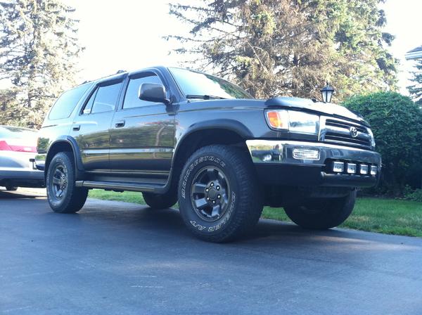

Hey Durrel... is your runner lifted? like the way it looks! please let me know. and i want to get tires just like those.. my rims are 15" thouggh. will 265/75/15 be just as big as yours?
