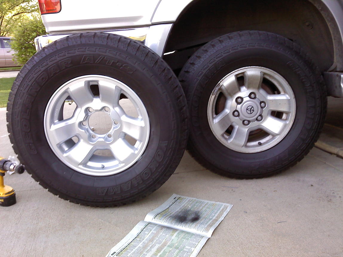

496 BB

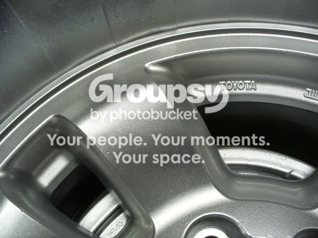

What steps did you take to prep you wheels as it looks like you have a wire wheel attached to you dewalt. Wheels look original. What paint did you use?
Also would like to see a pic of them on the 4R.
Let's see a whole vehicle shot with those rims painted, 496 BB. Looks awesome. Easy enough?
496 BB
The wire wheel was just there because I did the hitch also and it had a few little rust spots at the welds I wanted off before painting.
All I did was wash the wheel real good with clorox/water solution and let dry. Then I sanded/scuffed with red scotch brite pad real good everywhere and in every nook and cranny. Washed off again with Dawn soap and water. Made sure all spots were smooth and then finally wiped clean with rubbing alcohol and let dry. Then I taped off air valve and used playing cards and lined em around the whole rim where the tire is (great trick for whoever thought of this). Then I layed towels over the tire for overspray. I sprayed a basecoat of self etching Rustoleum primer. 2 of those in light coats. Waited till dry. Then I sprayed 2 coats of white metal primer so the silver would show up better/lighter as the self etching was a dark gray color. After that dried I used VHT (I think...will make sure...may been Duplicolor as one was darker and I didnt like it as well) silver wheel paint and sprayed 2 light coats followed by a medium coat and then a follow up coat as to make sure all was covered evenly. Within the hour I started spraying on the clear. I used about 4 coats and then let it set.
Its not hard to do by any means but I like doing this stuff soooo. If it lasts thats great but my expectations arent that great from a spray can. Who knows though Ive been wrong before as I thought this would look dumb to begin with....lol. I do have to say that the clear coat is pretty tuff. I used it on my trucks polished aluminum rims in one spot to see how it would last and its been 4-5 months and its still on there. But hey for $30 and rims that look like new again Im not *****ing.
Ill double check on that paint today when I finish the others up. Also getting the front airdam, rear bumper step, and deflector all painted body color next week so it should match up nice.

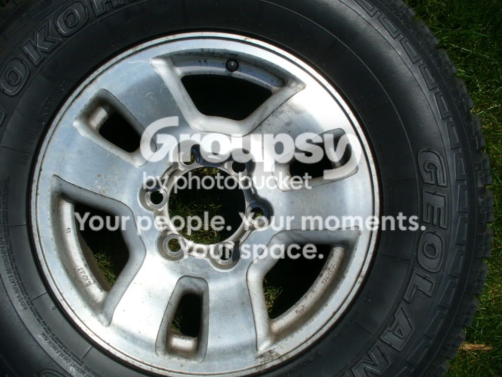

Wheels as they were ready to be cleaned
P1050308.jpg~original
Now once you have cleaned them (I used Purple Power degreaser and a rag with water) and hosed off good then proceed to prepping them. I used a combo of 400 grit wet sand for faces and red scotch brite pad for inside crevasses. There was some junk on them also where I think other wheel weights were that I used 150 grit to get off and followed it up with a 320 and finally the 400 wet sand. I suppose if you have rock chips and cuts this would be the time for a little filler and more sanding. After all prep is done re wash and hose off. Let air dry completely. Heres what it looked like after all this.

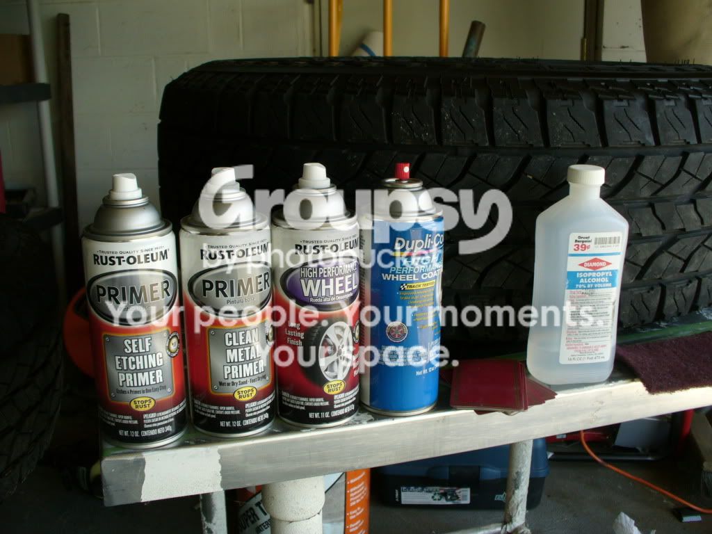

Heres the products I used. I used all Rustoleum products as their spray cans you can hold in any direction even upside down and it still sprays. The fan on the spray also seems better. I got it all at Auto Zone for around $30. Whats there is self etching primer (gray), metal primer (white), base coat (steel (actually silver in color though)), and clear coat. I used Dupli color clear until I ran out and used Rustoleum after. Both are good and I had Dupli here first. Rubbing alcohol and red scotchbrite pad. Also is deck of cards and rags/towels not pictured.

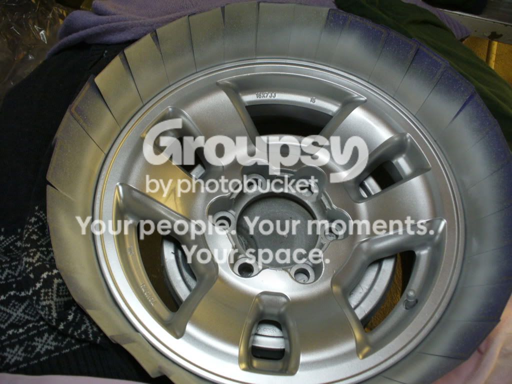

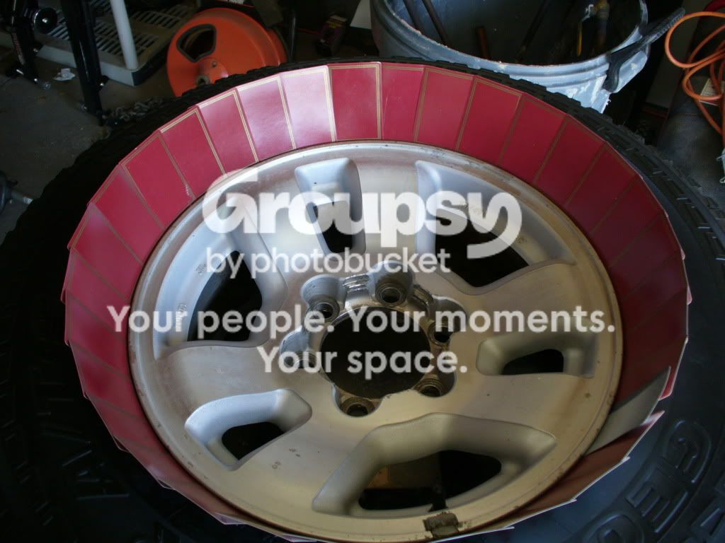

Heres how you do the cards.
P1050312.jpg~original

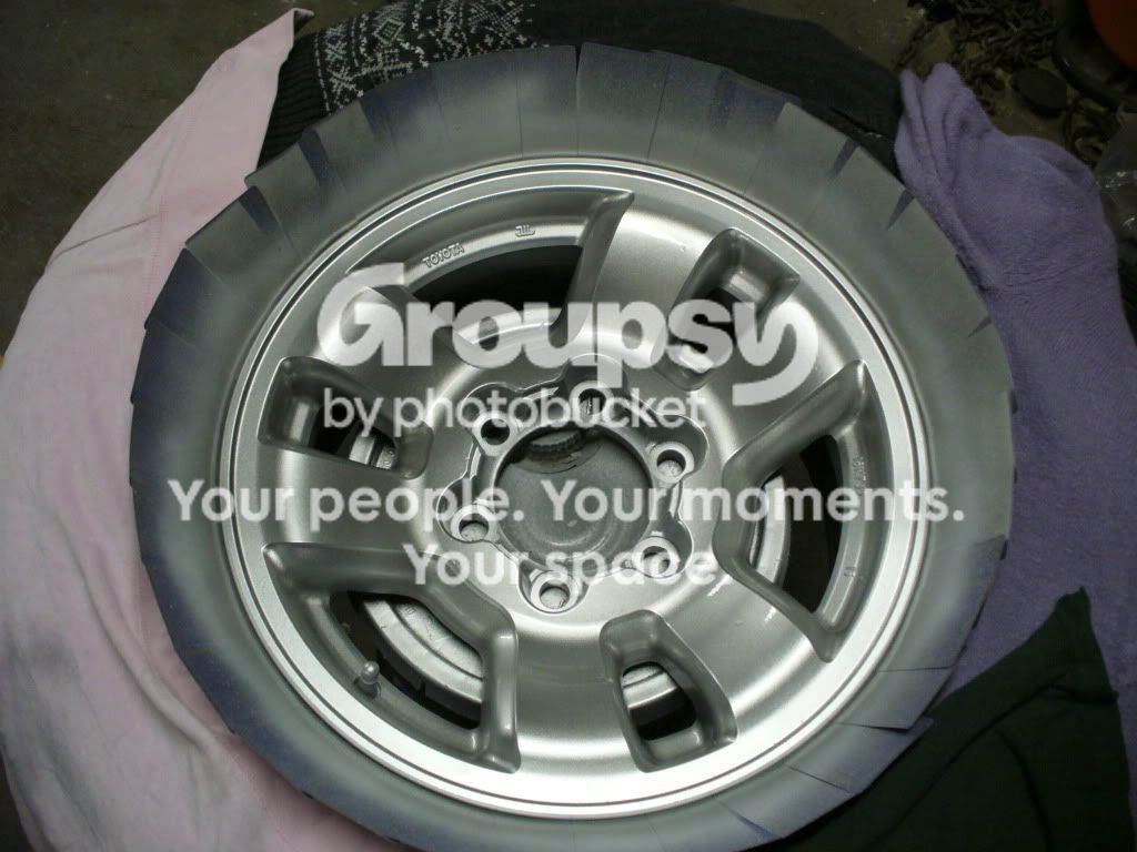

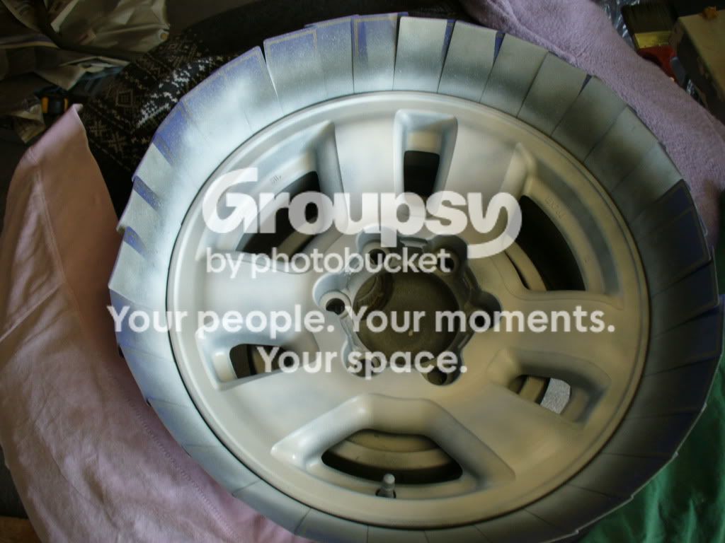

Spray on your self etching primer in two coats. Make the first coat a light mist trying to get in the tight areas first and working to facing last as thats the easiest and most inside areas overspray will get most of facings anyways. After two coats of that let dry per instructions and then repeat for the white metal primer. Must be white or silver wont show as good! Heres with first coat of metal primer.
P1050317.jpg~original

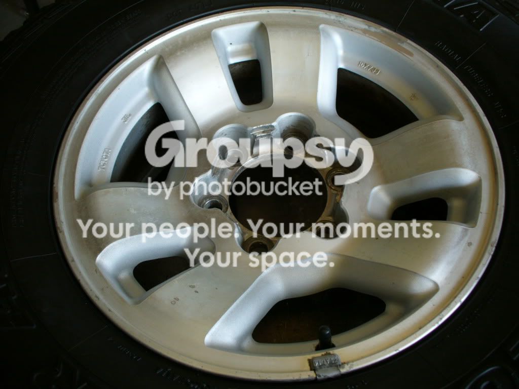

Once you let dry per instructions you can have two options. One is move on to base coat and other is wet sand. I didnt feel I needed a wetsand as it sprayed well so I moved on. Just do same with basecoat. Light coat first and gradually get more on. I put 3-4 coats of basecoat on.

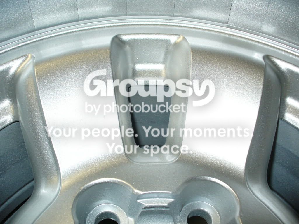

Look over every inch of your wheel once you think your done with basecoat and you will see you missed something on the inside of the spokes...Lol. Hit it again and let dry. After that its time for the clear. I always start all my paints by doing the outer most lip first. Base is no different. Go light mist first and then keep adding. I put on about 4-5 coats of clear. The more the better.
