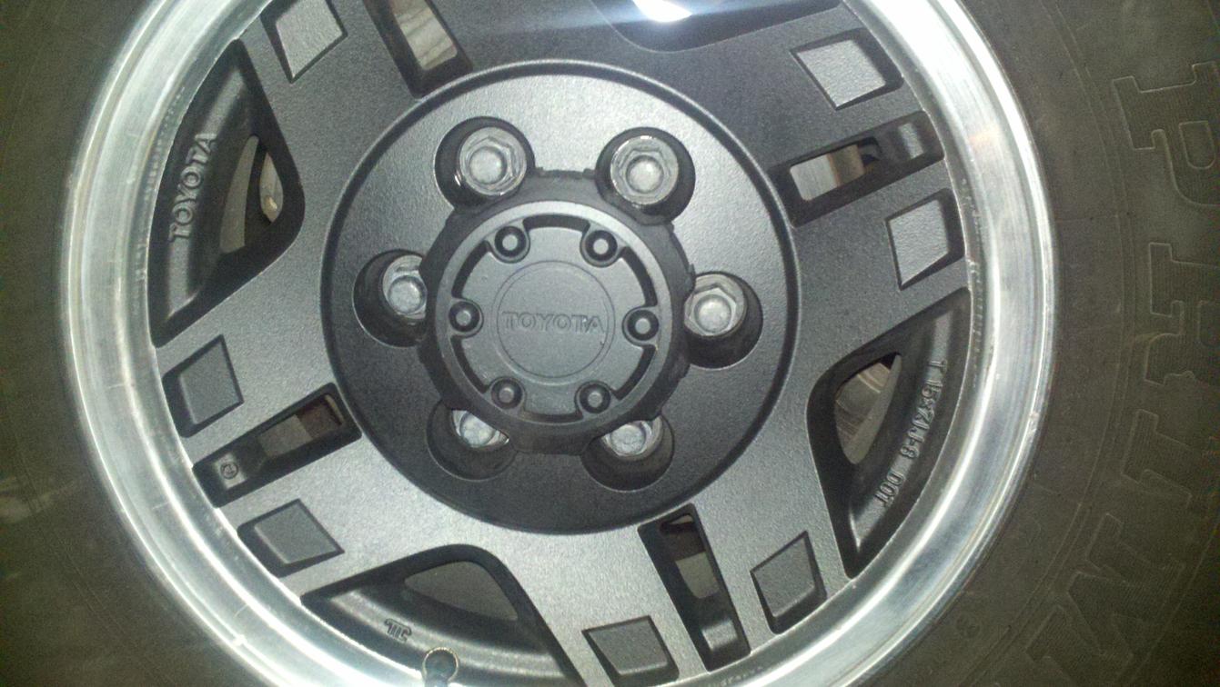

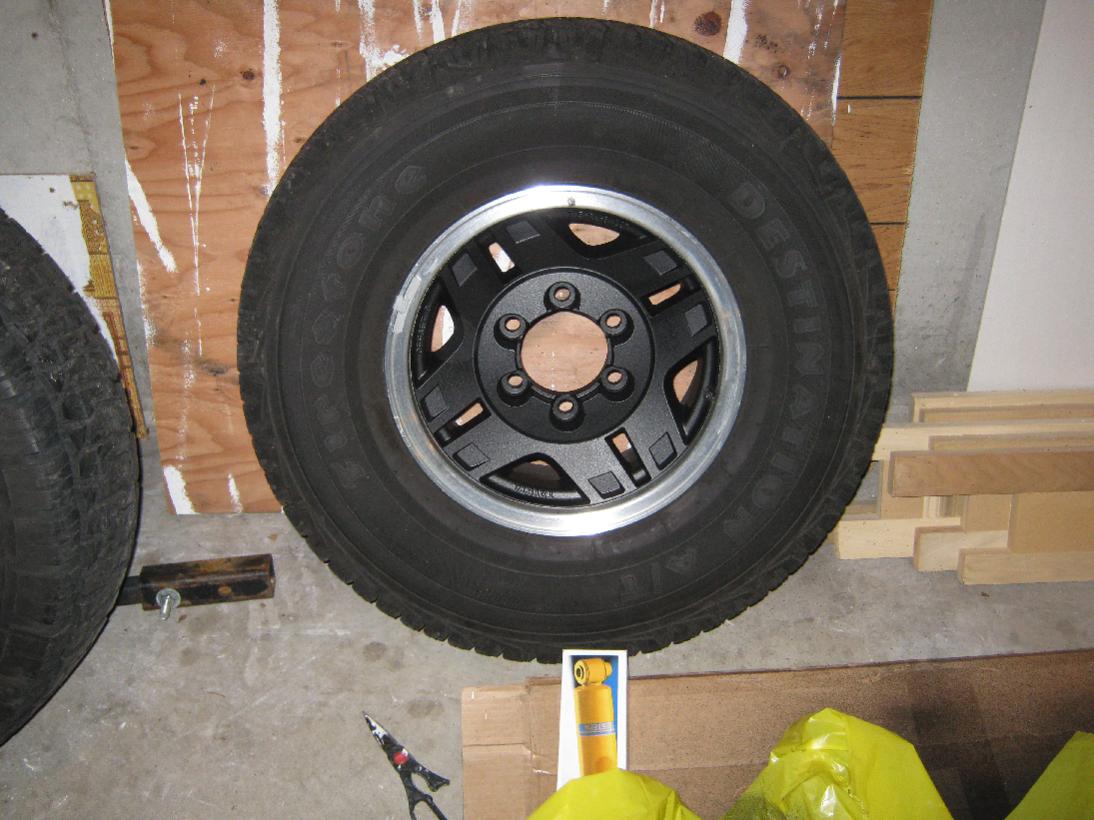

I plasti dipped my sr5 rims...they look great IMO. Fine grit sand, prime, then apply coats of the dip. I started light with the coats.

You were kind of my inspiration on this. I LOVE how yours came out.

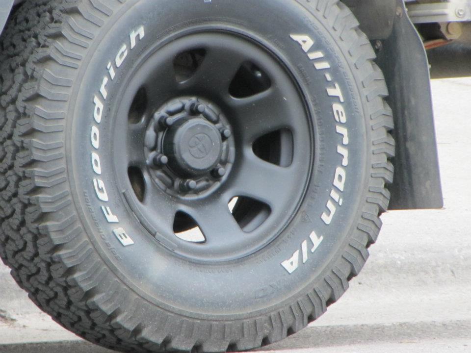

I just painted mine with good ol flat black krylon. Heck, I am decent with a spray can so I didn't even mask off my tires.....the paint is flat black after all. They look nice and only took 1 1/2 cans and about a half hour.
I figure, the time I spend having fun in my 4runner, the easy-fix Krylon was the way to go, but my rig is not nearly as nice as many of the rigs I see here.

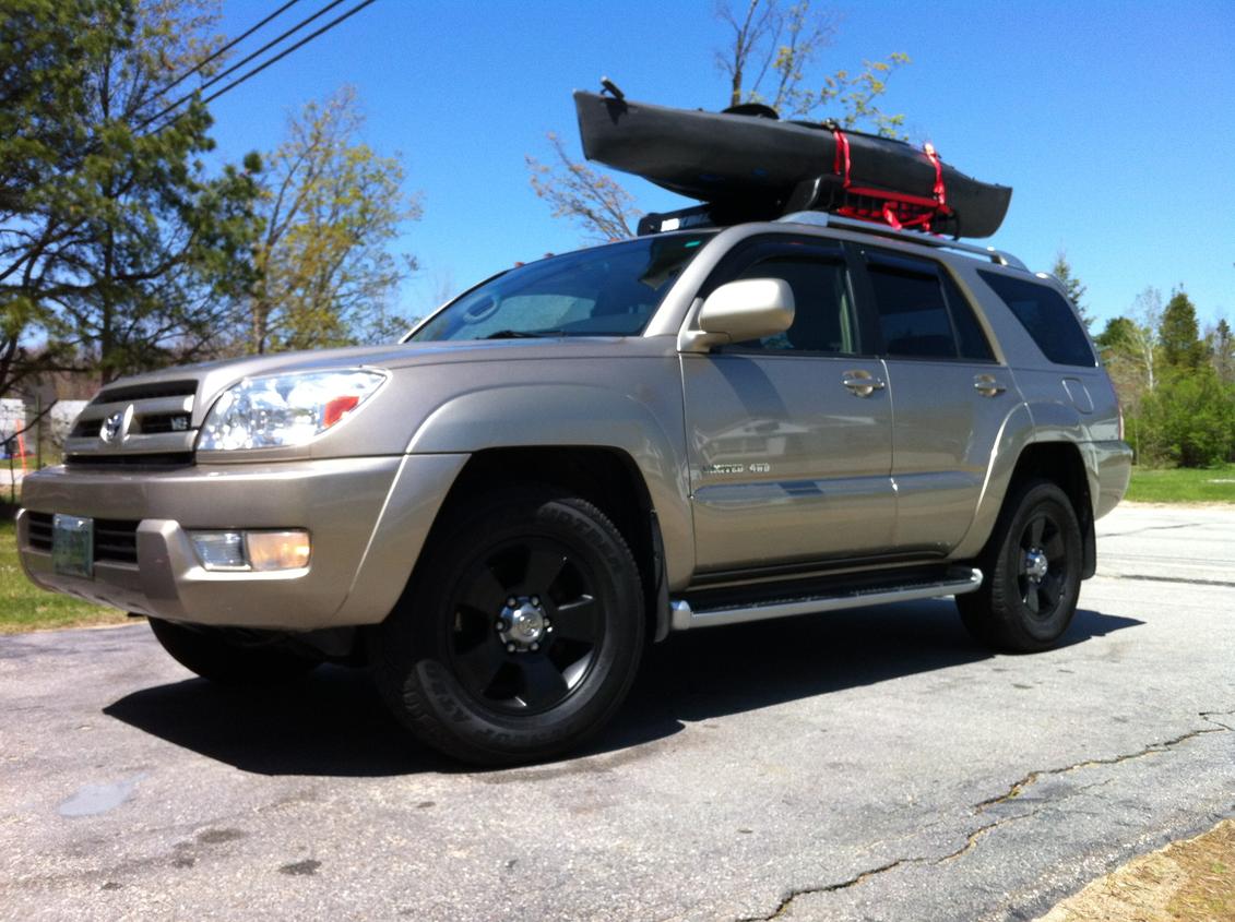

i just did mine at home, took about a day, used the index card trick, 320 grit sand paper, some self etching primer and a duplicolor rim paint. im really happy with the outcome, it's a flat black.
