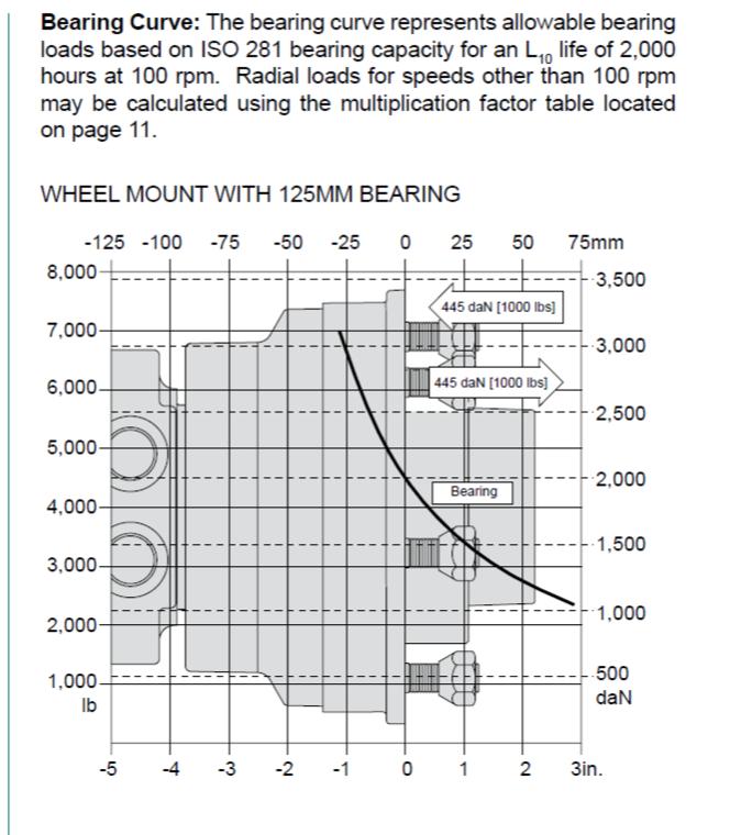

This isn't a toyota axle but im sure this info is out there for the toyota hubs this is just a hydraulic motor i use in some of my assembly designs for my company. Hopefully this gives you an idea of how a hub is affected by backspacing of the wheel. The left side of the chart shows the verticle load of the bearing/hub assembly in pounds. The bottom of the chart measuring in inches represents the location of the center of the wheel (i.e: if you have an 8" wide rim with 4" of back spacing this hub would hold 4500lbs or for you stock rimmers 7.5" wide rim with 3.75" of backspacing this hub would hold 4500lbs) if you added a 1" wheel spacer to this hub with and 8" wide rim 4" of backspacing your load rating (on this hub assembly) would drop to 3500lbs.
This is just food for the THIS IS NOT A TOYOTA HUB BEARING CURVE Im not saying your load rating will change by 1000lbs; however moving the center of the tire forward or rearward of the hub face will change the bearings load ratings
