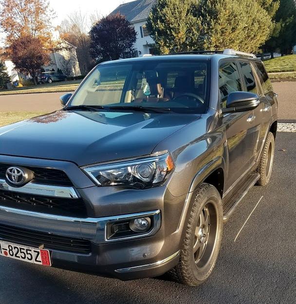

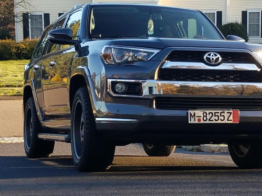

I just got some new wheels and I am wanting to push out the back a bit more, maybe 1/2 inch, is there a spacer that I can use that would achieve this?
Also pushing the back out more would not cause any rubbing, is that a correct assumption? I would push the front out too, but I think it may rub.
If I do a 3\2 inch lift can I push the front and back out by 1.25 front and 1.5 inch back without rubbing?
Here is my current set up
Thank you
