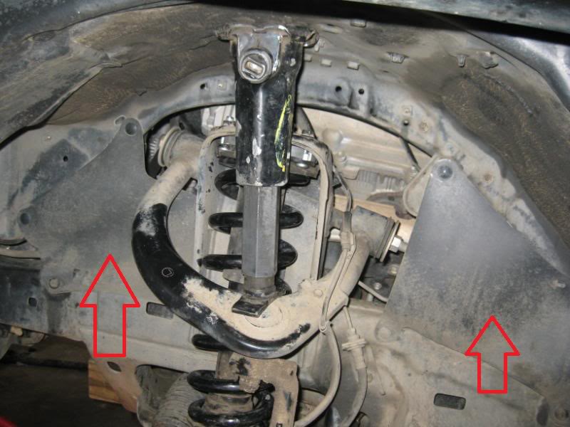

I have noticed lots of steam coming out from my front wheels while driving thru deep water on the roads.
I have looked at it and I can see my manifolds thru that gap behind a strut. I have two splash shields (rubber) on both sides of the strut but it looks like I'm missing one of them right behind the shock absorber. same story on the passenger side. I was wondering if I have lost that rubber splash shield or toyota didn't made them? There is some holes for a plastic clips.. Looks like lots of water coming on my manifolds and engine.
on this picture guy also have that "missing?" Part
I think others have been buying the FJ shields as they are the same and sometimes cheaper.
Mine were completely gone on both sides. Versus buying them I recently made some myself with some thicker rubber and short sheetmetal screws. Took a while with cardboard to template them out but they nearly seal off the wheel well now and should last many years for less than $15 in materials.
Made mine a year ago. Plastic showed up between a pallet and the boxes at work on a delivery. Templates with some old nilla file folders and a few bucks for the fasteners at a body shop, and done. The same fasteners in the "HELP" section at an auto parts store are too much $$$$..

i used a trash can, and cut the pieces. Got trash can and fasteners at Lowes, prob $15-$20 in all
How did this pan out? I would imagine the natural curve of trash cans (circular of square) to complicate the typically flat/easily flexible nature of the oem flaps.
I have pictures posted somewhere, and on my PC at the house. it worked out great, I cut the pieces out of the flat part of square can. This was done probably a year and half ago I think. All is still well! was very easy
