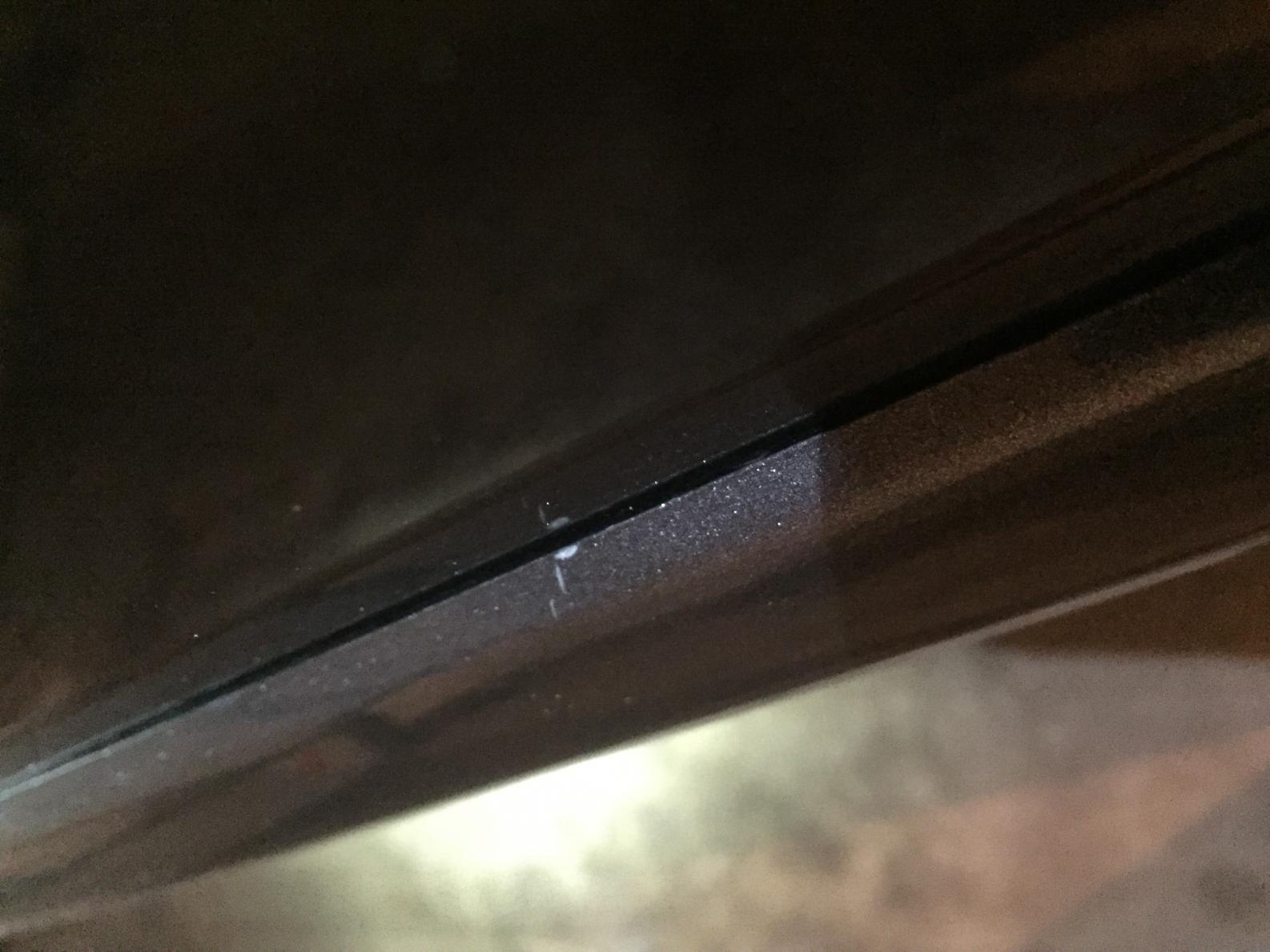

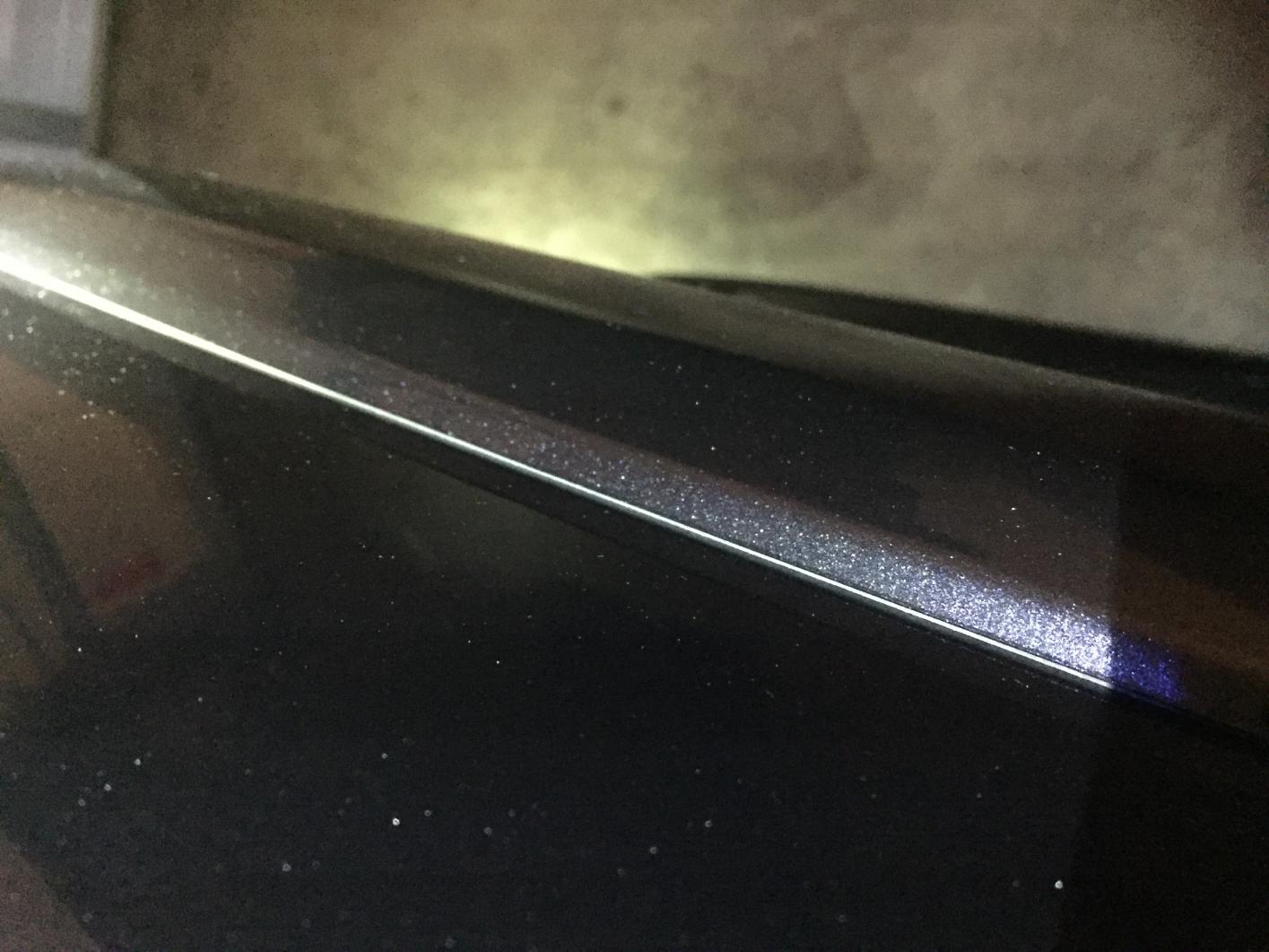

Second one you can see the gap and the scratch where they popped it off the side where I assume he used a plastic pry bar deal to NOT scratch it. FAIL. You can push it and there is ton of play. There was lots of play all down the back side, but it appears that tape is holding it tight to the body. Still not happy about the half ass job.
First pic is the right side that you can see the white line that is the black rubber seal that connects things water tight.
I am aware there are a bunch of clips that help hold it in place, but it was my understanding that this rubber seal is sticky all over and is the piece that seals out the rain.
My concern is that water running down the side will get behind the piece and just sit on the metal fender causing premature issues with rust etc years down the road.

The seal is reusable BUT a new one is $1.00 (one dollar)! The clips are one time use, once unclipped they will never be tight again. The clips are about $2.50 each from Toyota, I think it takes about 10. If you fix it right (do it yourself) you can get the clips from Lilparts.com for 39 Cents each.
Compatible with: Toyota 75395-35070 Wheel Flare Moulding Clip With Sealer
Thanks for the info. For the sealer part I didn’t see anything in your link about the long rubber seal part. Just the orange clips. Just want to make sure I’m reading what you put down correctly. I was assuming the seal is a roll that is rubber with a sticky outside all around for when you clip the piece back in it seals up very tightly. At this point I’d rather try it myself than have some ass hole joyriding in my car. Thanks for the info!
The seal part# is 75691-35070 / Flare Seal. Back when I did mine several years ago I got the seal from the dealer since it made no sense to ship it.
Also I recall that there was a mix of orange and blue clips. It's been too long for me recall the details. You will probably need to pop it off to see how many of each you will need. Lilparts had both. The blue ones are their part #AB-PC-023 -> Compatible with: Toyota 75396-35020 Rocker Moulding Clip With Sealer
