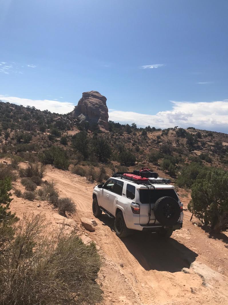

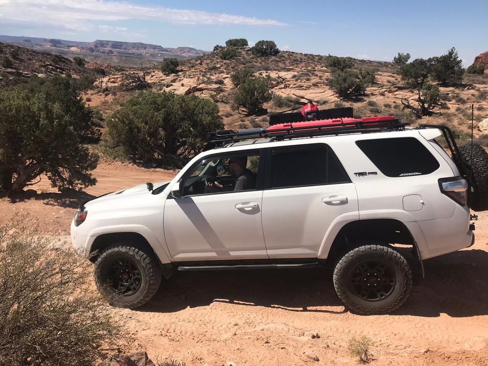

I have a set of airlift 1000 along with toytec superflex springs, I wheeled in Moab while running 15 psi in the bags and it did fine, so you airing them down to the 5 psi mark would be a non issue.
You can see in my pics that the bags allow for plenty of travel both ways
