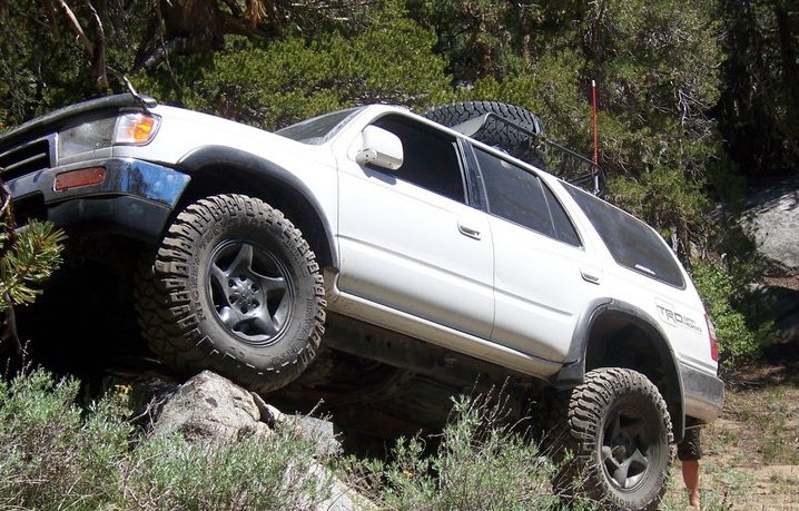

I have the same tires on my 97. They perform on all types of terrain phenomenally. They were also rated the #1 off road tire in 4wd magazine primarily because of the self cleaning aspect. Mine are set on Tundra rims and the backspacing on the rim is barely enough to clear the upper control arm. Take a close look and make sure there isn't any rubbing which of course you wouldn't notice unless you were flexed or in a deep turn. All in all nice choice and enjoy them!

heres a picture of mine.

Great lookin rig! The backspace on the sidebiters is 4.5". Isn't that the same as the stock rims I have or less?
Everything i have read says the Tundra rims are 4.625 backspaced but i also have 285's which can also impact tire rub on the upper control arm. I also have a lift which brings the upper control arm up. I think you will be alright but may run into a challenge if you ever intend on lifting it.
I really like those wheels! You shouldn't rub with 265/75s on those Sidebiters with 4.5" BS even if you lift it. 285s would probably rub a little though like Toy4ever said. Congrats, I wanna see the pics!!!
