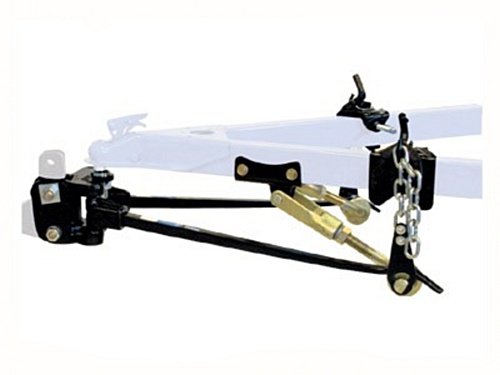

Man, if your trailer starts hydroplaning I don't think it will matter....ouch, I have a Reese Straight-Line on mine but once again I have a 20ft Toy Hauler that when loaded can weigh close to 7000lbs but to each their own...you can't put a price on safety!!
On a side note like charlier180 says there are a lot of variables....weather, distributing the weight evenly, other drivers on the road....everything.
